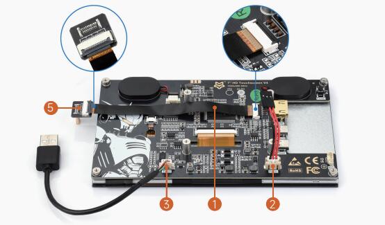

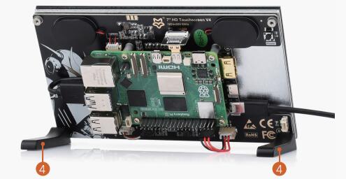

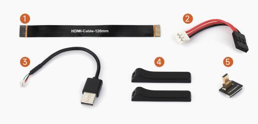

Prepare the cables as shown in the image below. The following will use the Raspberry Pi 5 as a demonstration for the connection.
Connect cables ①, ② and ③ to their corresponding positions as shown in the image below. Connect cable ① to the LCD adapter ⑤ and connect it to the Raspberry Pi's micro HDMI port.
3.Connect cable ③ to the Raspberry Pi’s USB port, and cable ② to the Raspberry Pi’s 5V and GND pin headers.
4.After all cables are connected, ensure everything is properly connected and power the system with a 5V power supply to use it.
