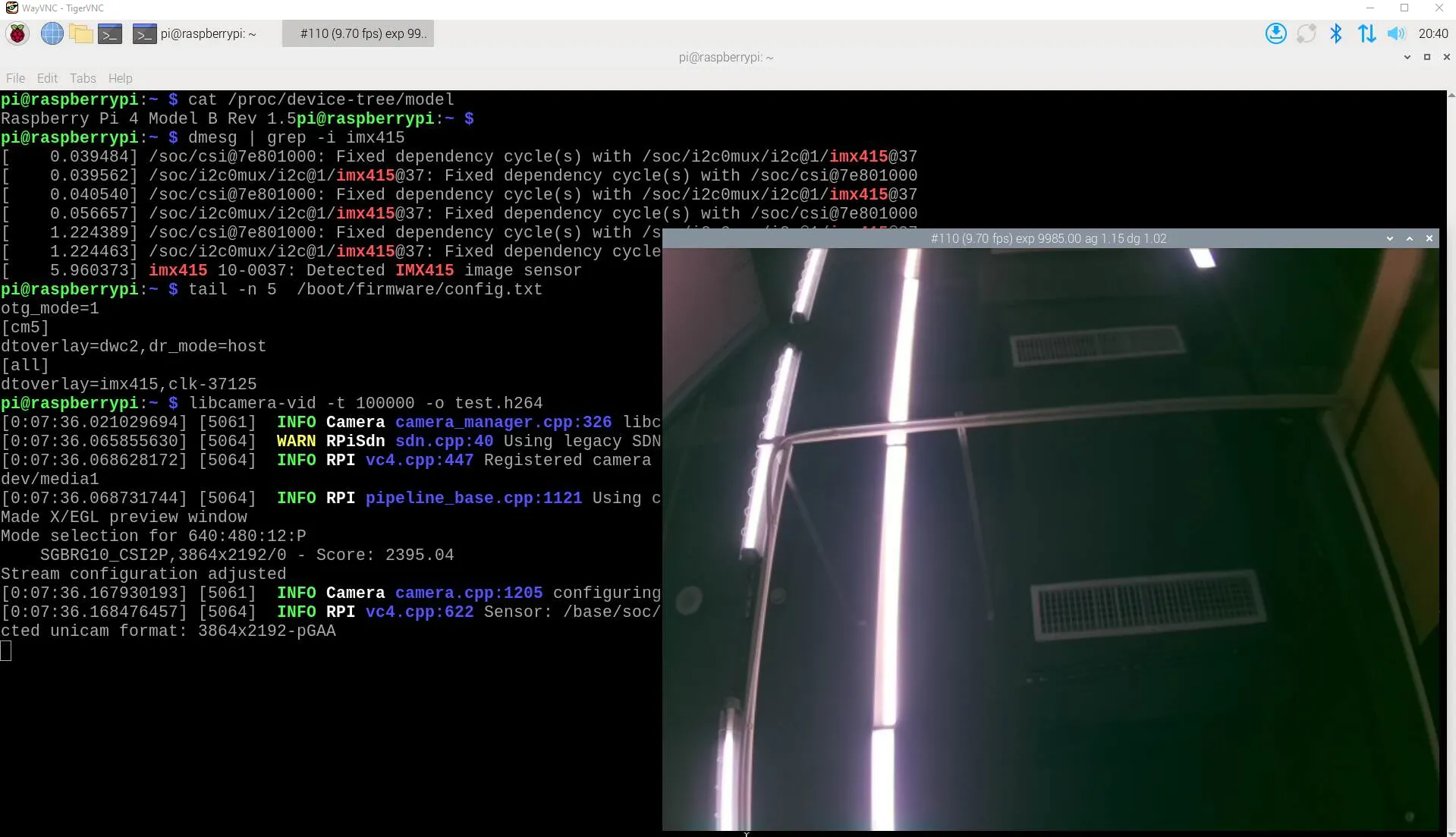

4. Usage on Raspberry Pi 4B/5
Flash the latest Raspberry Pi OS. Other operating systems are not supported.
Edit
/boot/firmware/config.txtand add the following line at the end:dtoverlay=imx415,clk-37125 -
Reboot the Raspberry Pi and check whether the driver loaded correctly:
dmesg | grep -i imx415 -
Start the camera preview:
libcamera-vid -t 100000 -o test.h264
- Preview:
