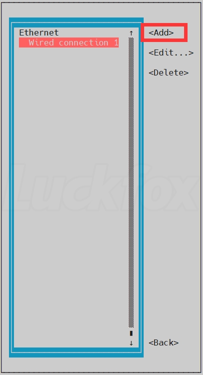

  3. Select "Edit a connection" and press Enter.
  4. Press the "Add" button.

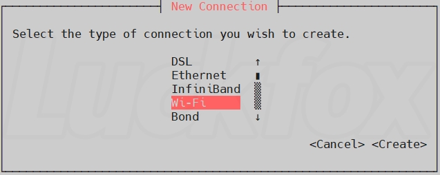

  5. Choose Wi-Fi from the list of network types, then press Enter.

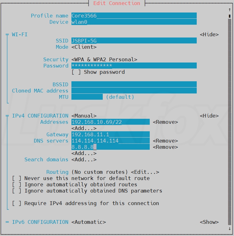

  6. Enter a name for the NetworkManager configuration file to easily identify the purpose of the configuration set.
  7. Enter the network device name in the "Device" field.
  8. Enter the name of the Wi-Fi network (Service Set Identifier - SSID) in the "SSID" field.
  9. Set the Mode to the default value "Client."
  10. Select "Security," press Enter, and then choose the authentication type for the network from the list.
  11. Fill in the password for the wireless network.
  12. If the Wi-Fi network requires a static IP address:
    • Press the "Automatic" button next to the protocol and then select "Manual" from the displayed list.
    • Press the "Show" button next to the protocol you want to configure to display additional fields and fill them in.
    • Enter the static IPv4 address, netmask, default gateway, and DNS servers.
  13. Press the "OK" button to create and automatically activate the new connection.
