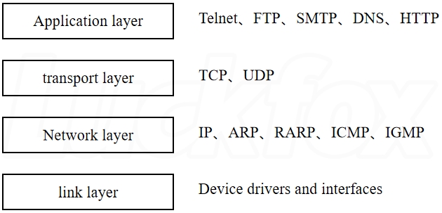

Network protocols are typically developed in different layers, with each layer responsible for different communication functions. A protocol family, such as TCP/IP, is a combination of multiple protocols on different layers. TCP/IP is usually considered a four-layer protocol system::
  • Application Layer: The top layer of the TCP/IP protocol stack, providing an interface between applications and the network. It includes various application protocols, such as HTTP, FTP, SMTP, etc. The application layer handles the communication requirements of specific applications and provides data exchange capabilities for applications.
  • Transport Layer: Responsible for end-to-end communication between hosts in the network. It uses TCP and UDP protocols to achieve reliable data transmission and flow control. Specific functions are as follows:
    • TCP Protocol: Provides reliable, connection-oriented communication. It handles data segmentation, sequencing, retransmission mechanisms, and congestion control.
    • UDP Protocol: Provides unreliable, connectionless communication. It is more lightweight and does not provide data reliability and sequencing, making it suitable for applications with high real-time requirements.
  • Network Layer: Responsible for packet transmission and routing selection between hosts in the network. It uses the IP protocol to implement packet forwarding and addressing. Specific functions are as follows:
    • IP Protocol: Defines the format and transmission methods of data packets in the Internet. It uses IP addresses to identify hosts on the network and determines the transmission path of data packets through routing algorithms.
  • Link Layer: Responsible for data frame transmission in the physical network. It interacts directly with the network adapter (NIC) and handles physical layer details. Specific functions are as follows: Ethernet is the most commonly used link layer protocol, defining data frame formats, medium access control, and address resolution, among others.

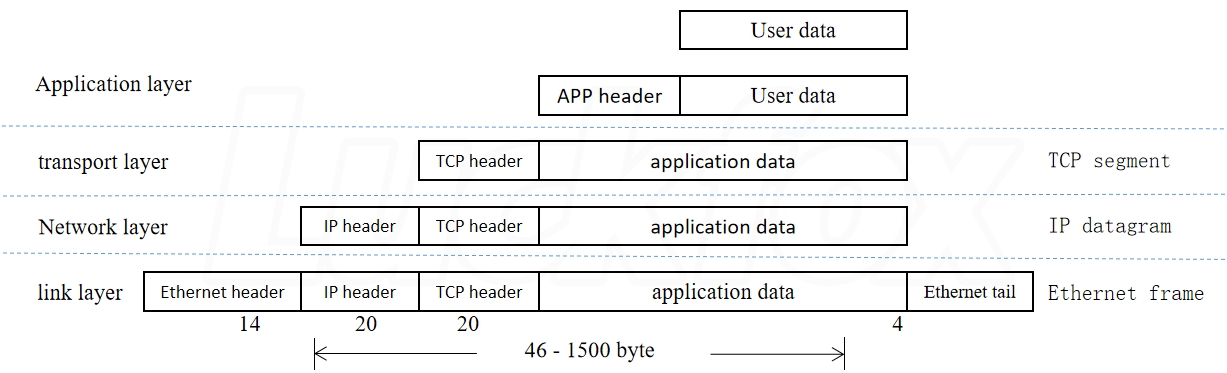

Different protocol layers have different names for data packets: at the transport layer, they are called TCP segments; at the network layer, they are called IP datagrams; and at the link layer, they are called Ethernet frames.
At the sender, starting from the transport layer, each layer adds a header to the data from the layer above to form the data for this layer; this process is called data encapsulation. At the receiver, starting from the lowest layer, each layer removes the header information from the data; this process is called data de-encapsulation.
