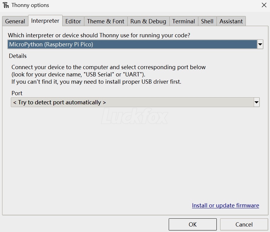

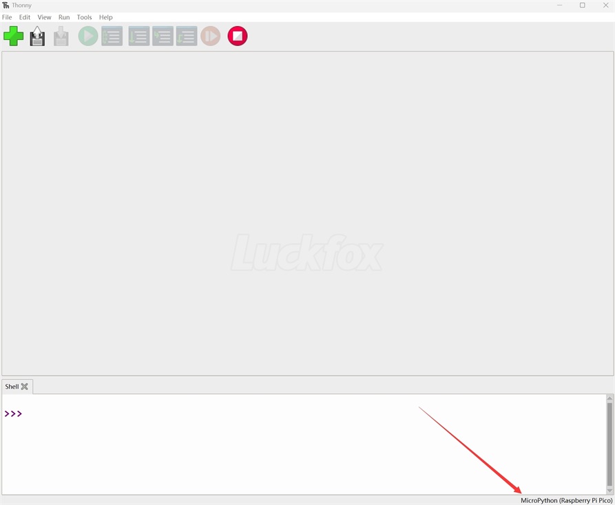

    • Connect Pico/Pico2 to your computer first, and in the lower right corner of Thonny left-click on the configuration environment option --> select Configture interpreter
    • In the pop-up window, select MicroPython (Raspberry Pi Pico), and choose the corresponding port

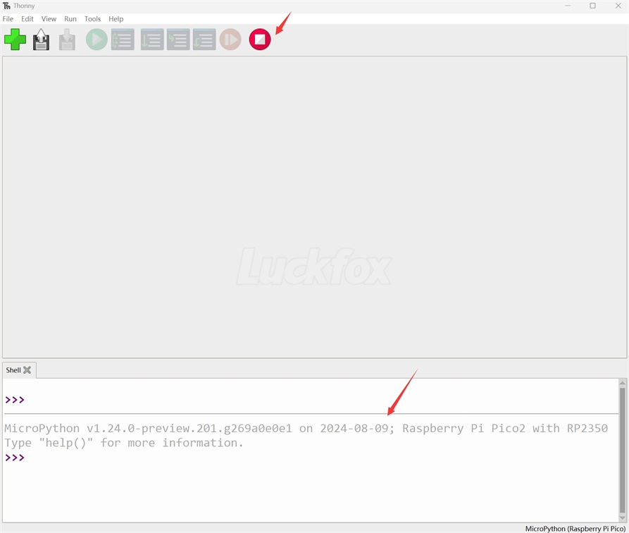

Flash Firmware

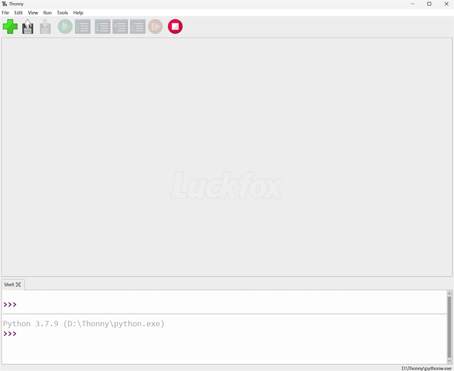

  • Click OK to return to the Thonny main interface, download the corresponding firmware library and burn it to the device, and then click the Stop button to display the current environment in the Shell window
  • Note: Flashing the Pico2 firmware provided by Micropython may cause the device to be unrecognized, please use the firmware below or in the package
  • How to download the firmware library for Pico/Pico2 in windows: After holding down the BOOT button and connecting to the computer, release the BOOT button, a removable disk will appear on the computer, copy the firmware library into it
  • How to download the firmware library for RP2040/RP2350 in windows: After connecting to the computer, press the BOOT key and the RESET key at the same time, release the RESET key first and then release the BOOT key, a removable disk will appear on the computer, copy the firmware library into it (you can also use the Pico/Pico2 method)

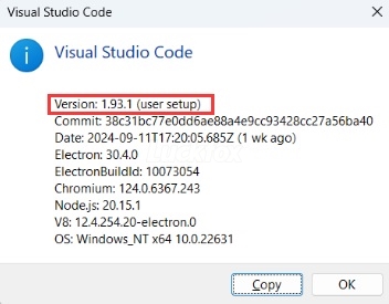

Install VSCode

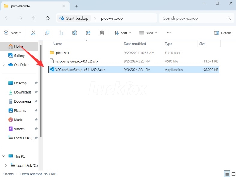

  1. First, click to download pico-vscode package, unzip and open the package, double-click to install VSCode

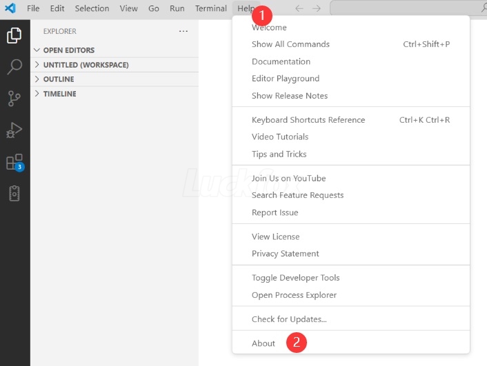

    Note: If vscode is installed, check if the version is v1.87.0 or later

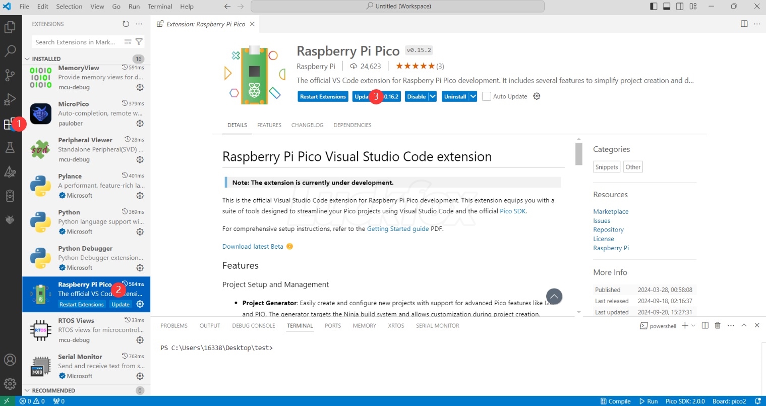

Install Extension

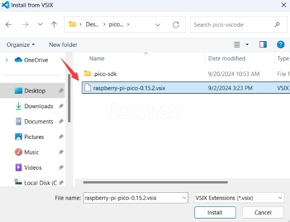

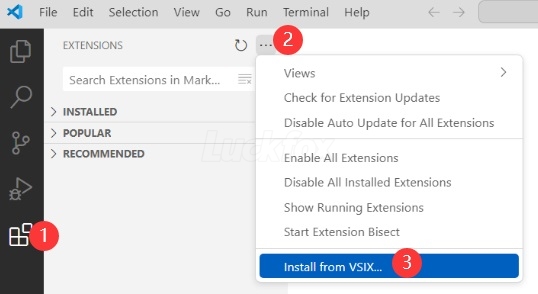

  1. Click Extensions and select Install from VSIX
  2. Select the package with the vsix suffix and click Install

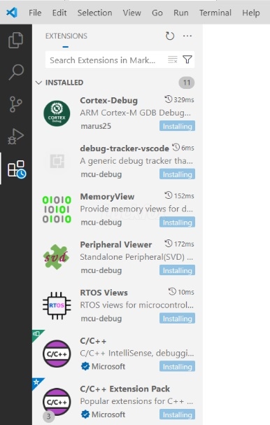

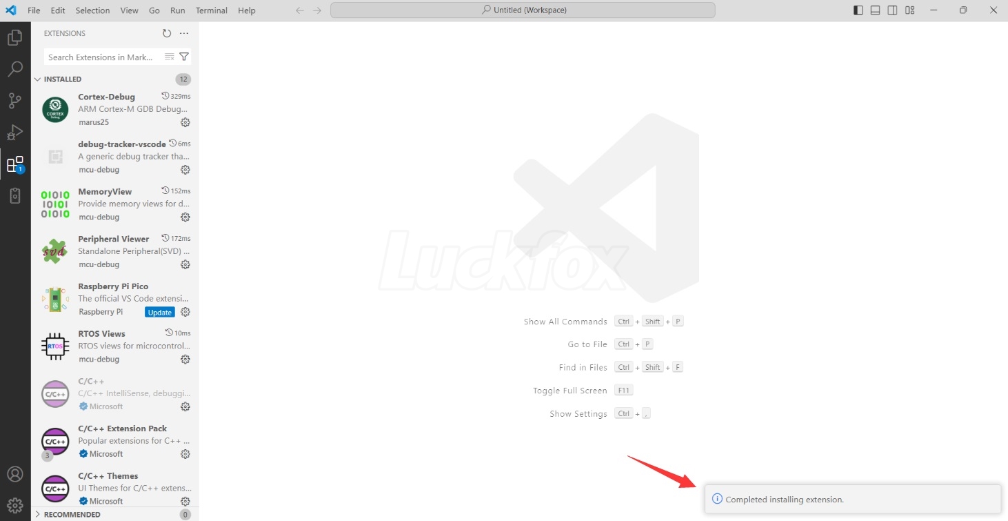

  3. Then vscode will automatically install raspberry-pi-pico and its dependency extensions, you can click Refresh to check the installation progress
  4. The text in the right lower corner shows that the installation is complete. Close VSCode

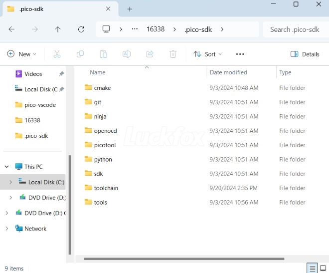

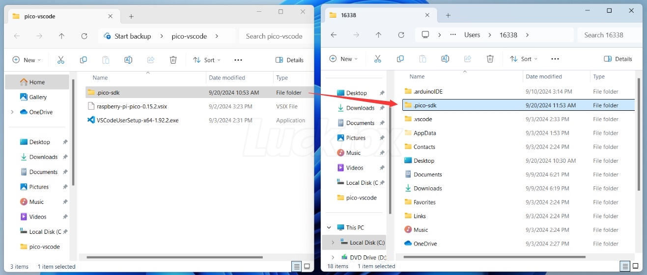

  1. Open directory C:\Users\username and copy the entire .pico-sdk to that directory
  2. The copy is completed

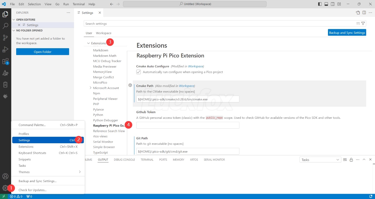

  3. Open vscode and configure the paths for the Raspberry Pi Pico extensions
    The configuration is as follows:
    Cmake Path:
    ${HOME}/.pico-sdk/cmake/v3.28.6/bin/cmake.exe
    Git Path:
    ${HOME}/.pico-sdk/git/cmd/git.exe
    Ninja Path:
    ${HOME}/.pico-sdk/ninja/v1.12.1/ninja.exe
    Python3 Path:
    ${HOME}/.pico-sdk/python/3.12.1/python.exe

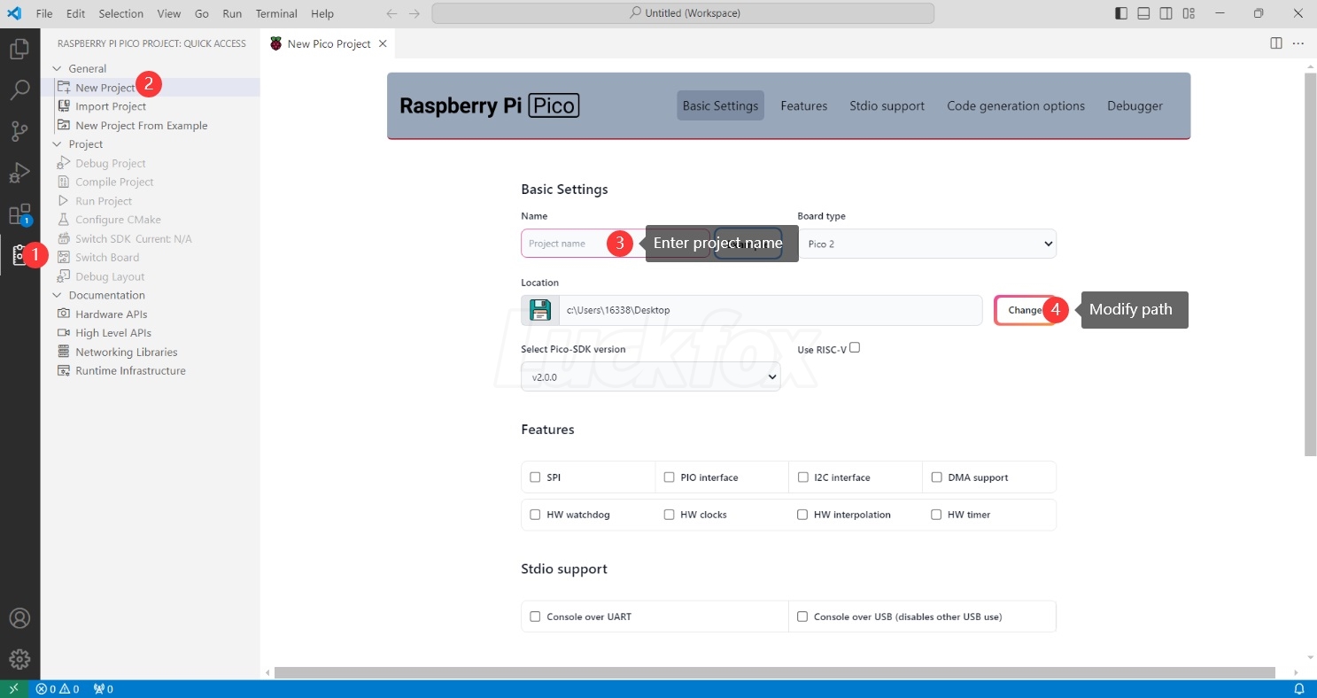

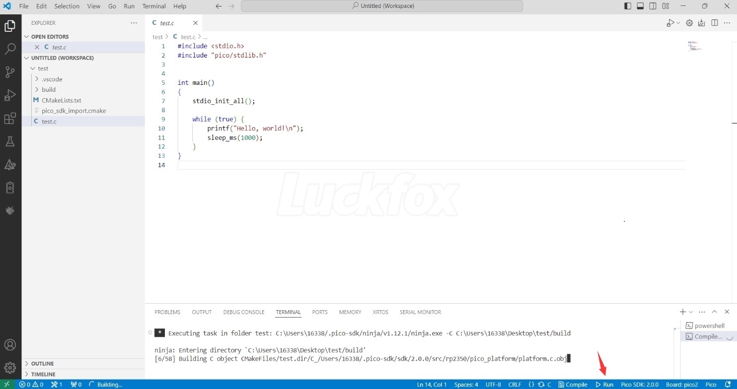

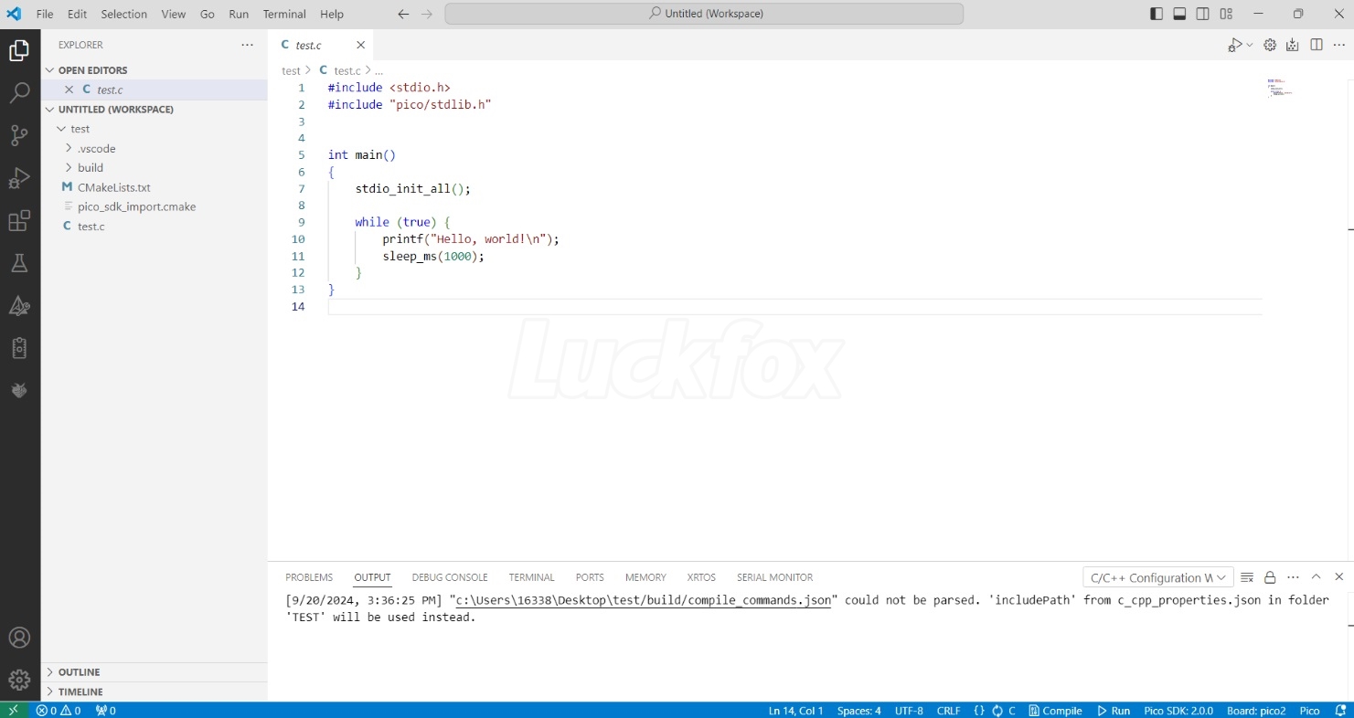

New Project
  1. The configuration is complete, create a new project, enter the project name, select the path, and click Create to create the project To test the official example, you can click on the Example next to the project name to select
  2. The project is created successfully
Compile Project

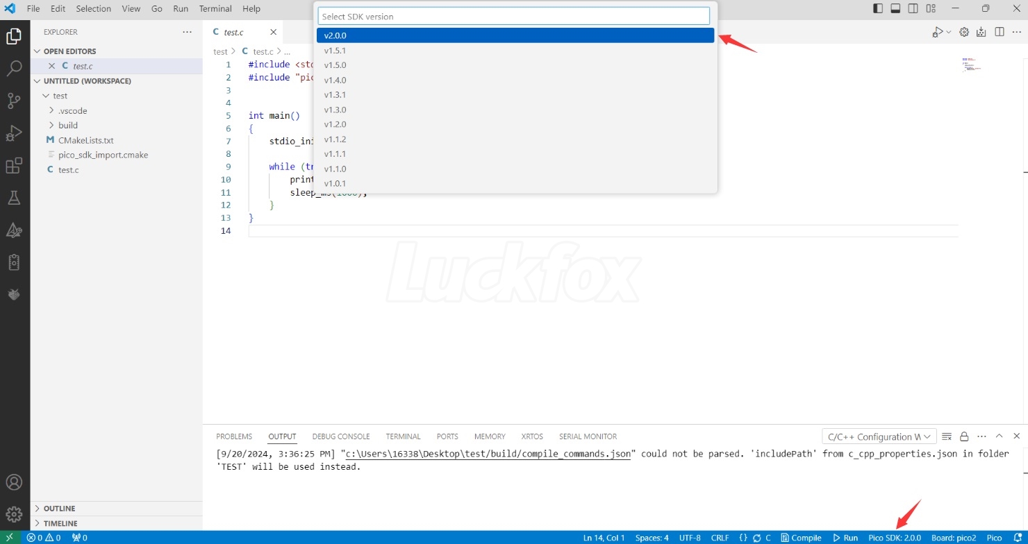

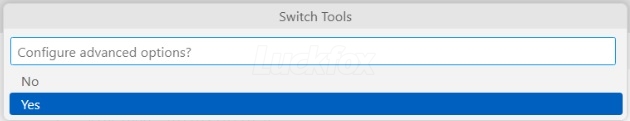

  1. Select the SDK version
  2. Select Yes for advanced configuration

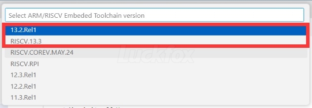

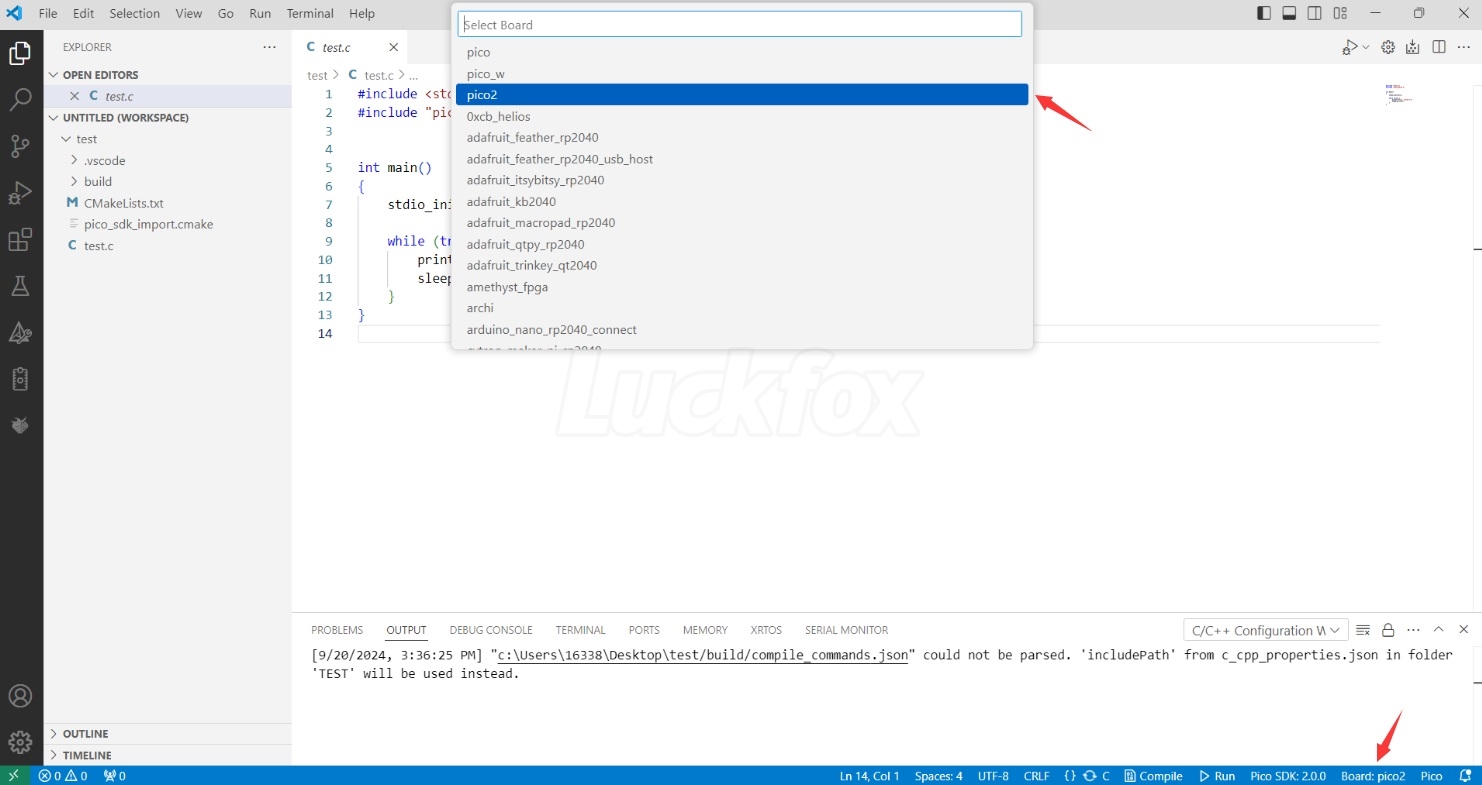

  3. Choose the cross-compilation chain, 13.2.Rel1 is applicable for ARM cores, RISCV.13.3 is applicable for RISCV cores. You can select either based on your requirements

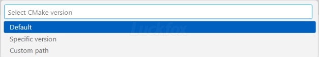

  4. Select Default for CMake version (the path configured earlier)

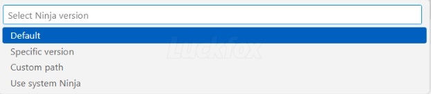

  5. Select Default for Ninjaversion
  6. Select the development board

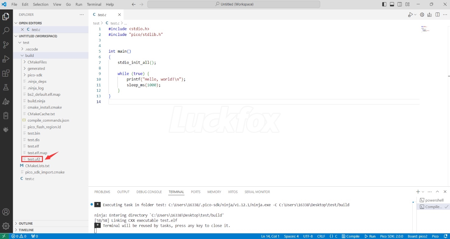

  7. Click Complie to compile
  8. The uf2 format file is successfully compiled

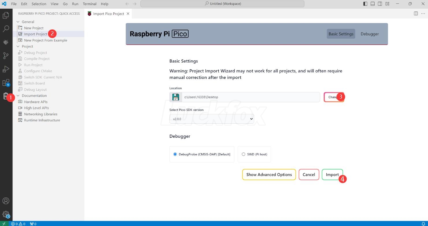

  1. Select the project directory and import the project

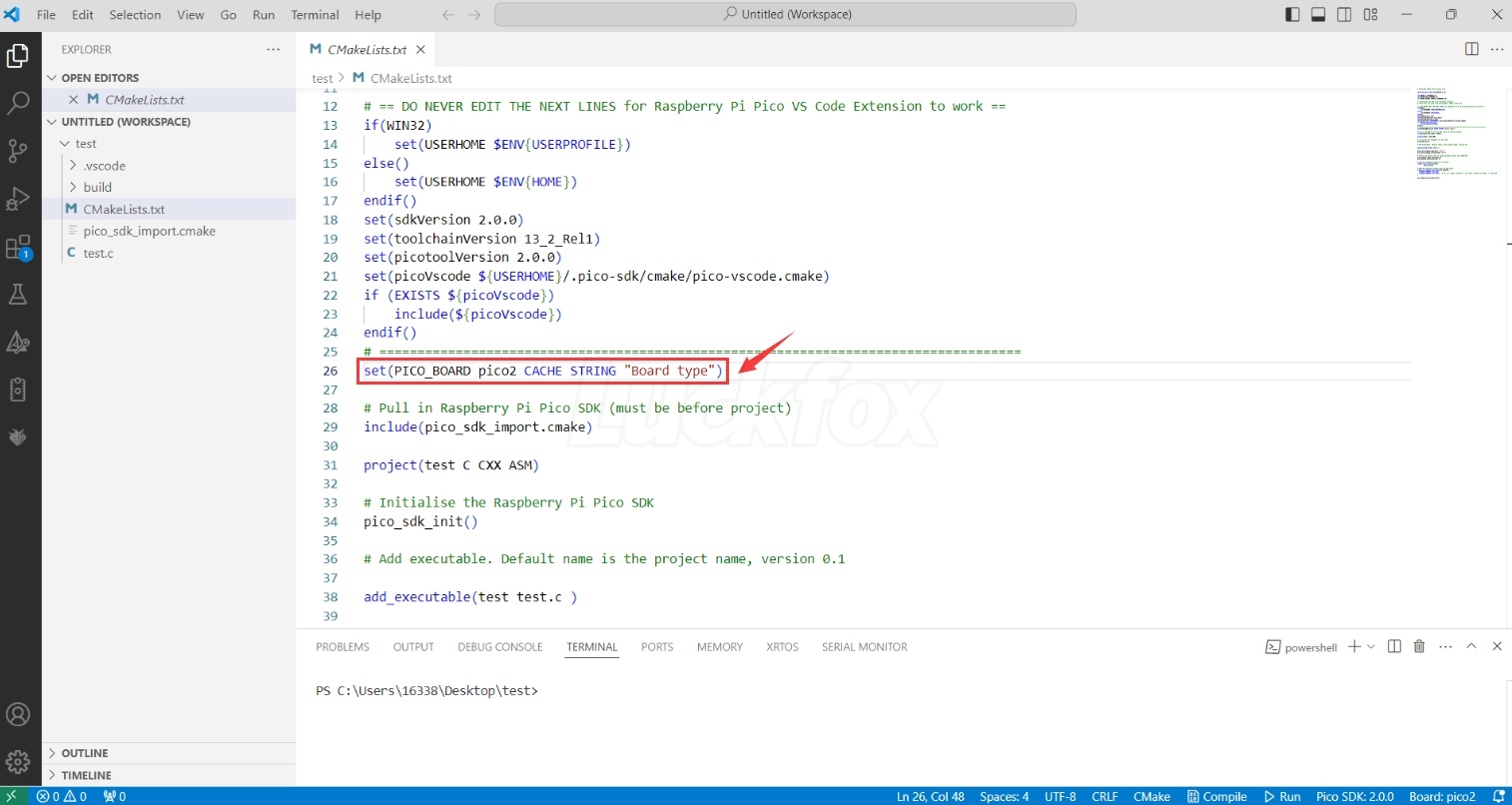

  2. The Cmake file of the imported project cannot have Chinese (including comments), otherwise the import may fail
  3. To import your own project, you need to add a line of code to the Cmake file to switch between pico and pico2 normally, otherwise even if pico2 is selected, the compiled firmware will still be suitable for pico
    set(PICO_BOARD pico CACHE STRING "Board type")

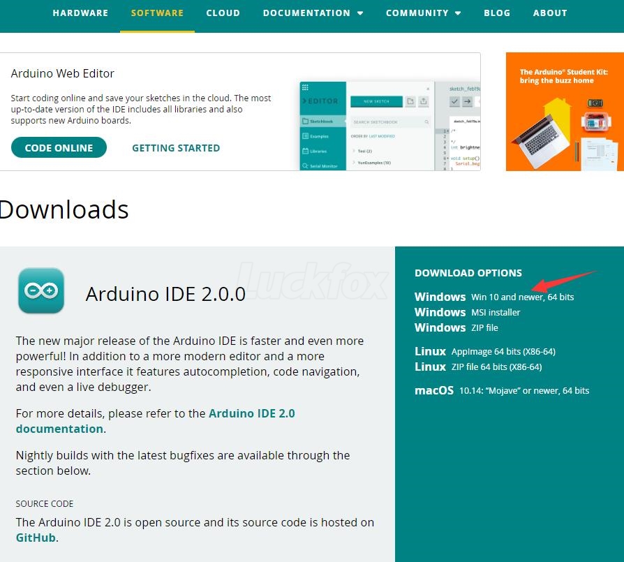

  1. First, go to Arduino official website to download the installation package of the Arduino IDE.
  2. Here, you can select Just Download.
  3. Once the download is complete, click Install. Notice: During the installation process, it will prompt you to install the driver, just click Install

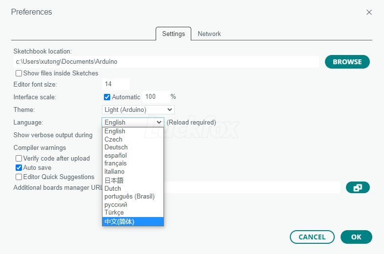

  1. After the first installation, when you open the Arduino IDE, it will be in English. You can switch to other languages in File --> Preferences, or continue using the English interface.
  2. In the Language field, select the language you want to switch to, and click OK.

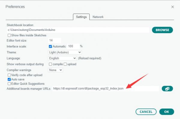

Install Arduino-Pico Core in Arduino IDE
  1. Open the Arduino IDE, click on the file in the top left corner, and select Preferences
  2. Add the following link to the attached board manager URL, and then click OK
    This link already includes board versions such as RP2040 and RP2350. Please visit arduino-pico for the latest version files
    https://github.com/earlephilhower/arduino-pico/releases/download/4.5.2/package_rp2040_index.json
    Pico首选项.png Note: If you already have an ESP32 board URL, you can use a comma to separate the URLs as follows:
    https://dl.espressif.com/dl/package_esp32_index.json,https://github.com/earlephilhower/arduino-pico/releases/download/4.5.2/package_rp2040_index.json

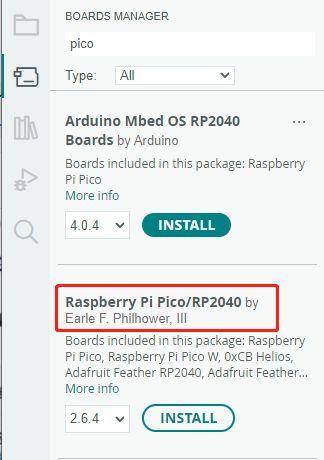

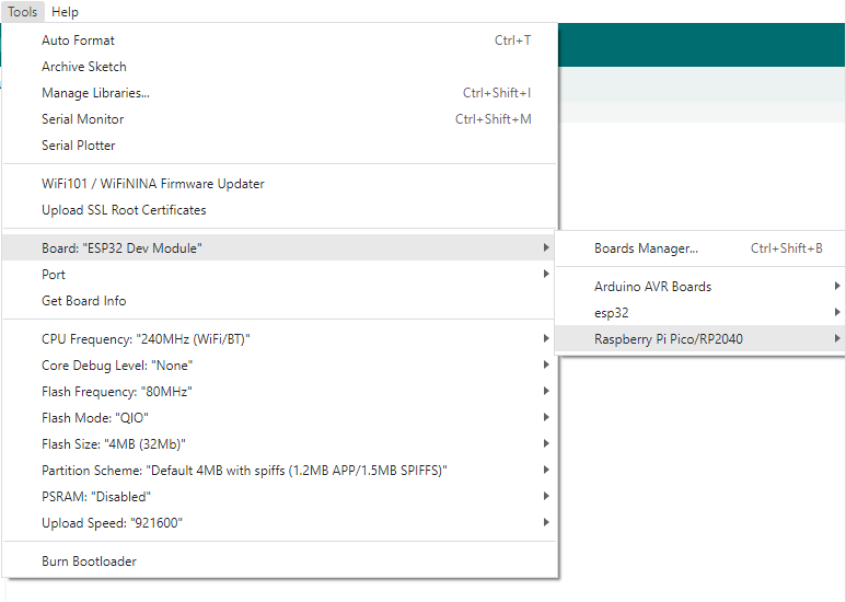

  3. Click Tools > Development Board > Board Manager > Search pico, as my computer has already been installed, it shows that it is installed

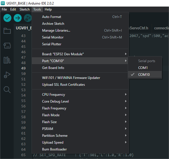

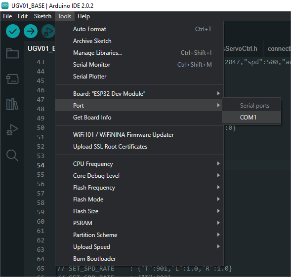

  3. Click Tools --> Port, remember the existing COM, do not click this COM (the COM displayed is different on different computers, remember the COM on your own computer)
  4. Connect the driver board to the computer using a USB cable. Then, go to Tools > Port. For the first connection, select uf2 Board. After uploading, when you connect again, an additional COM port will appear
  5. Click Tools > Development Board > Raspberry Pi Pico > Raspberry Pi Pico or Raspberry Pi Pico 2
  6. After setting it up, click the right arrow to upload the program
