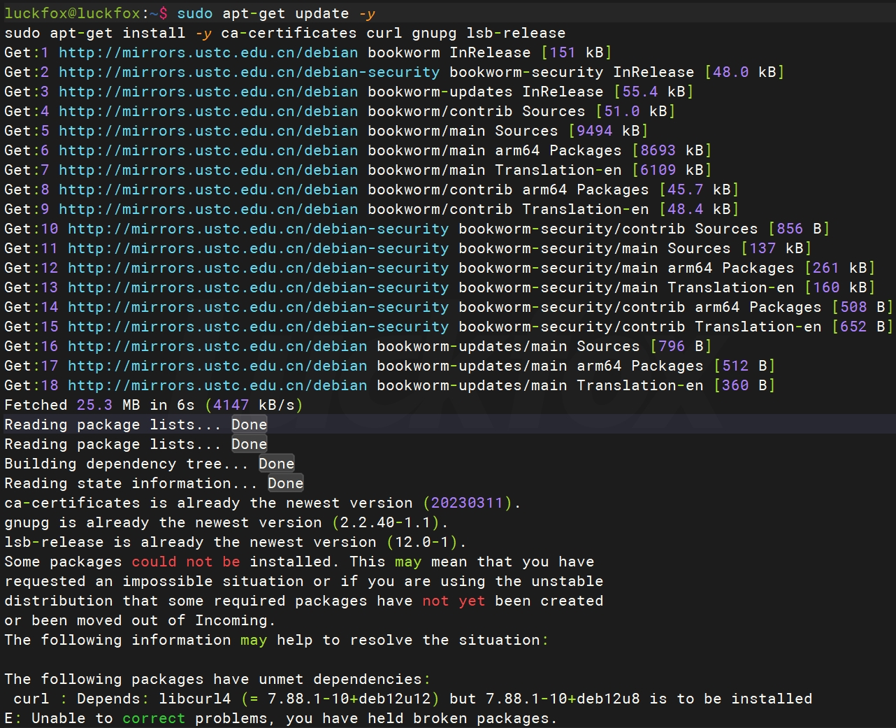

  1. 更新 APT 包索引并安装依赖项:
    sudo apt-get update -y
    sudo apt-get install -y ca-certificates curl gnupg lsb-release

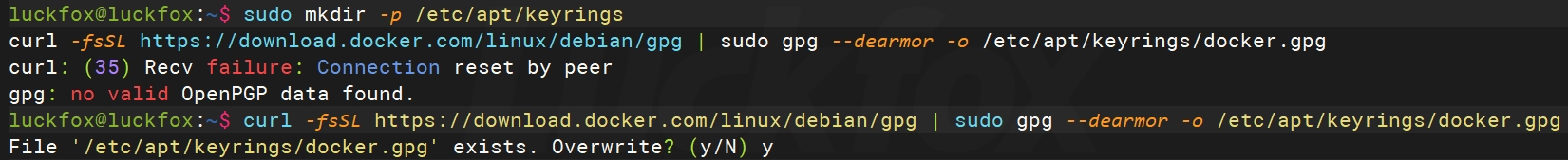

  2. 创建密钥存放目录并导入 GPG 密钥:
    sudo mkdir -p /etc/apt/keyrings
    curl -fsSL https://download.docker.com/linux/debian/gpg | sudo gpg --dearmor -o /etc/apt/keyrings/docker.gpg

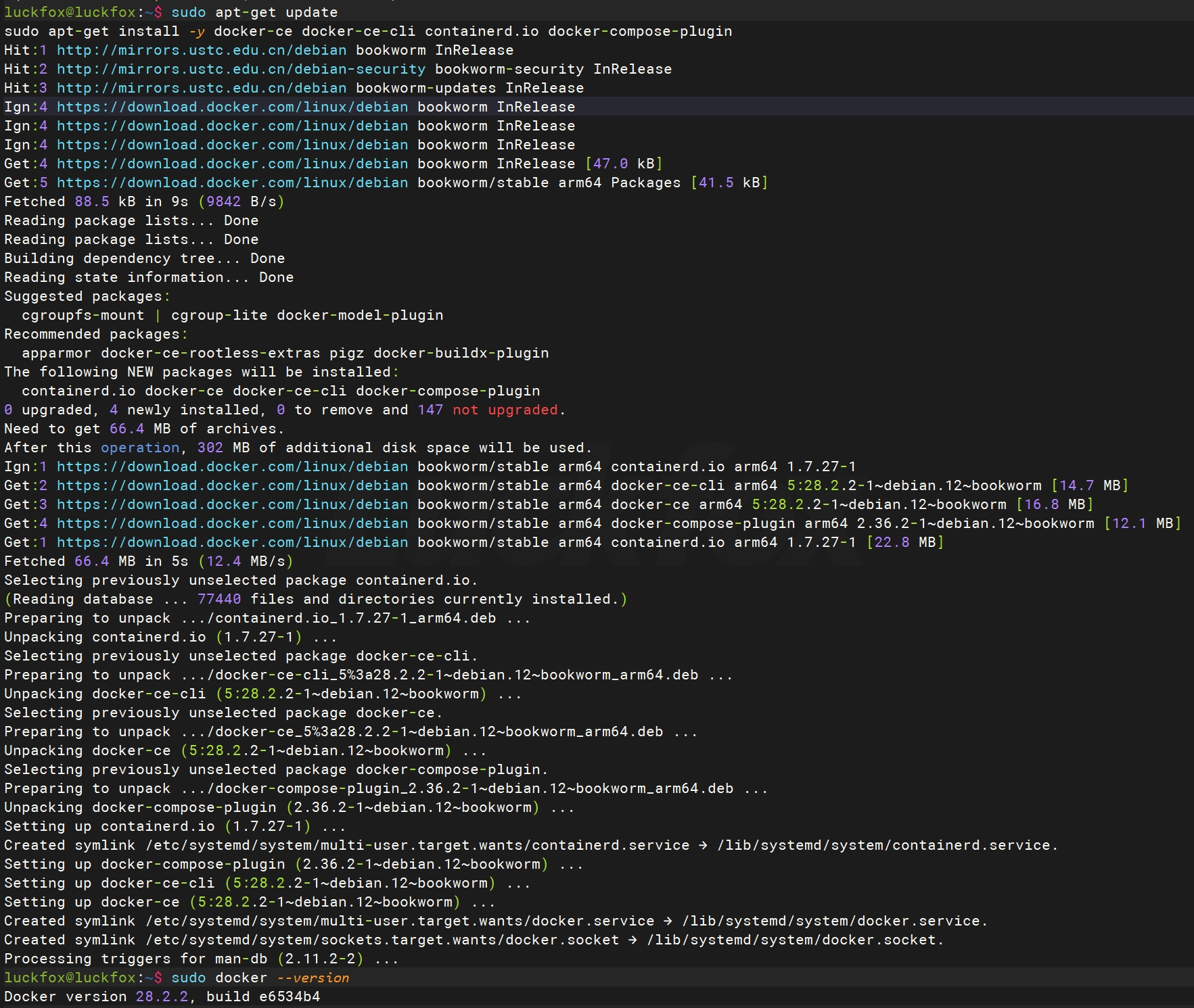

  4. 安装 Docker 引擎及相关组件:
    sudo apt-get install -y docker-ce docker-ce-cli containerd.io docker-compose-plugin
  5. 验证 Docker 是否安装成功:
    sudo docker --version

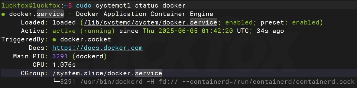

  6. 查看 Docker 进程:
    sudo systemctl status docker
