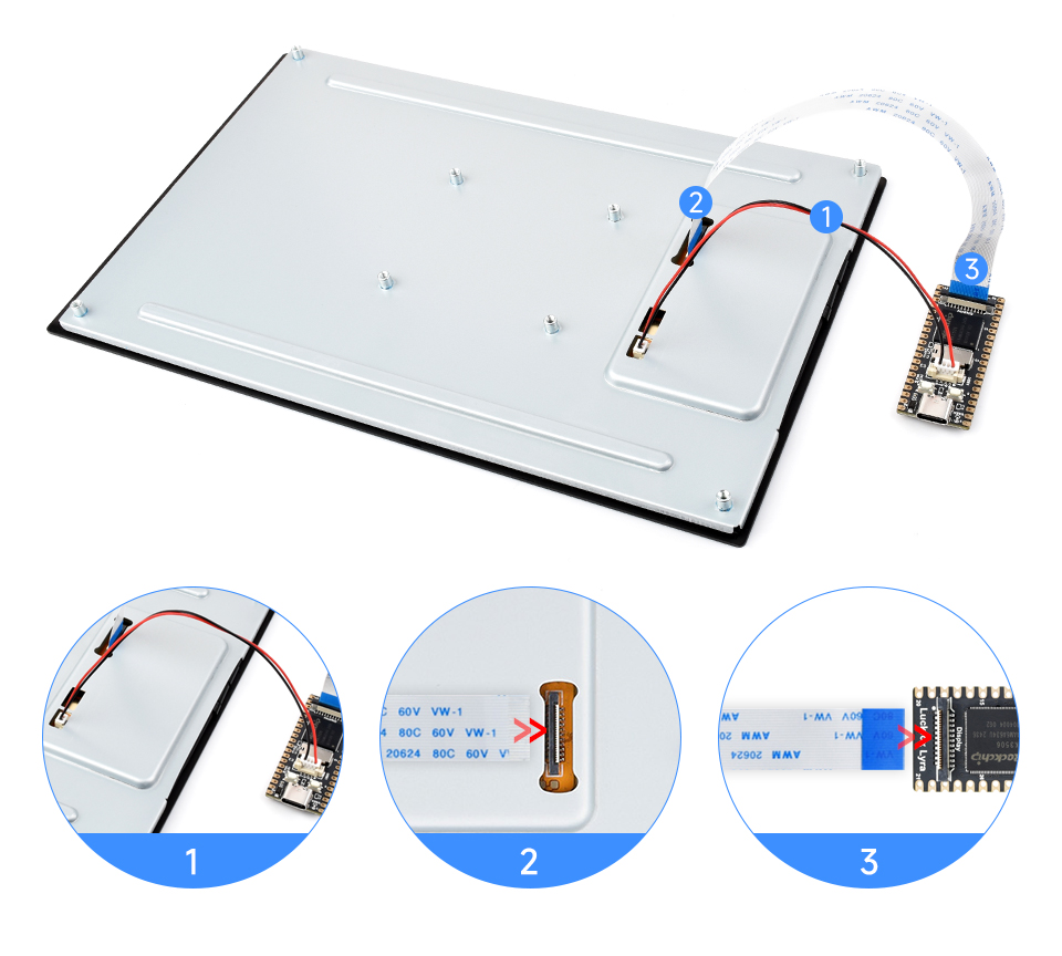

Luckfox Lyra Connecting to 10.1-DSI-TOUCH-A Screen
  1. Use a 22PIN FPC cable to connect the display’s DSI interface to the DSI interface on the Luckfox-Lyra motherboard. (Note: The blue end of the cable should face the development board’s chip.)
  2. Use an MX1.25 2PIN to 4PIN connector cable to connect the display’s power interface to the USB MX1.25 4P interface on the Luckfox-Lyra motherboard. As shown below:
