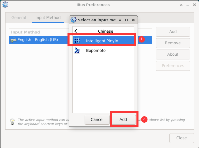

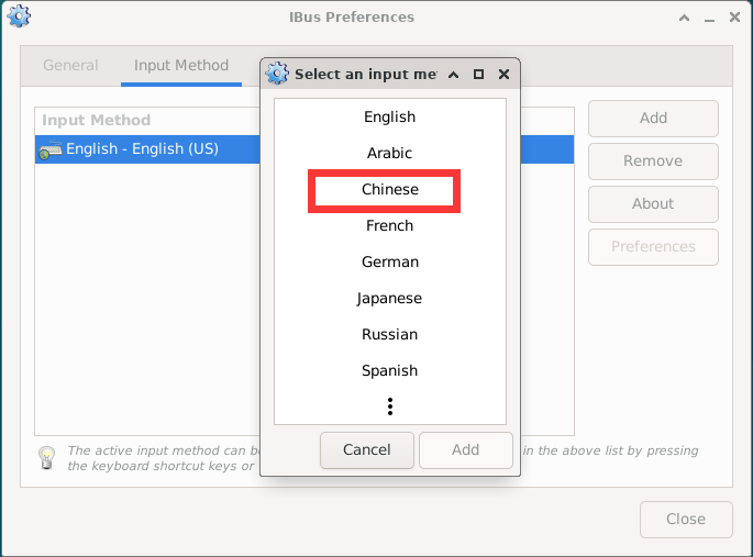

  4. Configure the Chinese input method.
    ibus-setup
    • In the setup window:
      • Navigate to Input Method -> Add
      • Select Chinese -> Intelligent Pinyin
      • Click Close to exit
