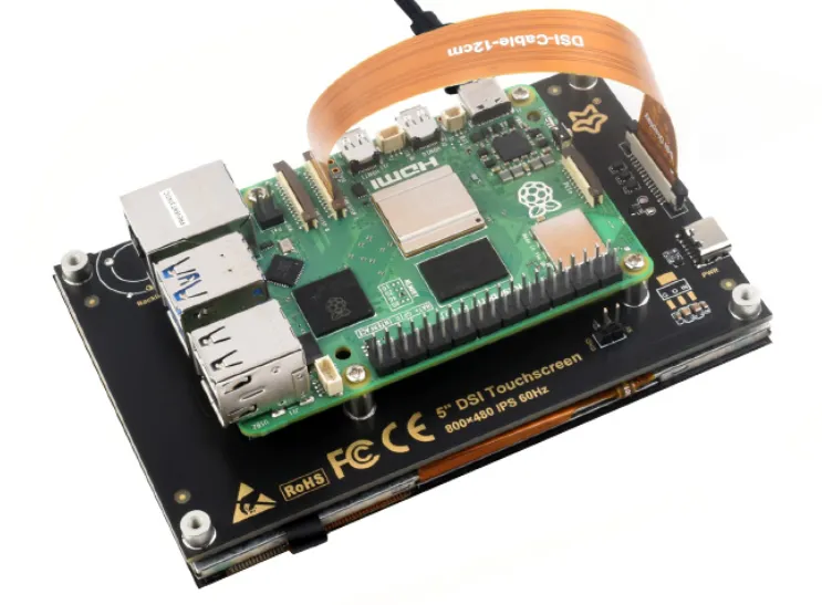

  1. Use an FFC cable to connect the 5inch DSI LCD to the 15-pin DSI interface on the Raspberry Pi board.
  2. For convenience, you can secure the Raspberry Pi board to the back of the 5inch DSI LCD using screws and assemble the standoffs, as shown in the image below:
