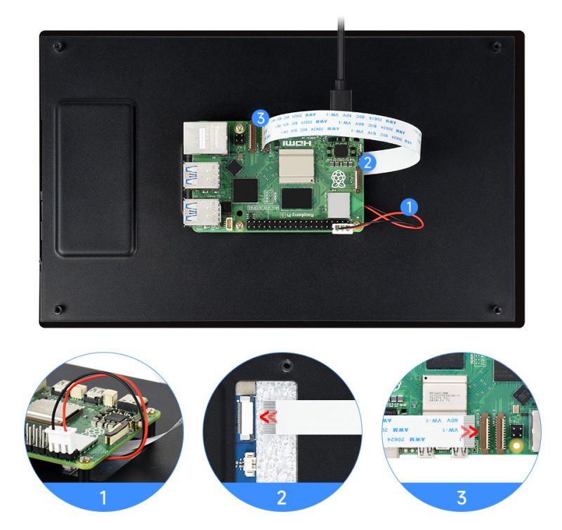

Working with Raspberry Pi

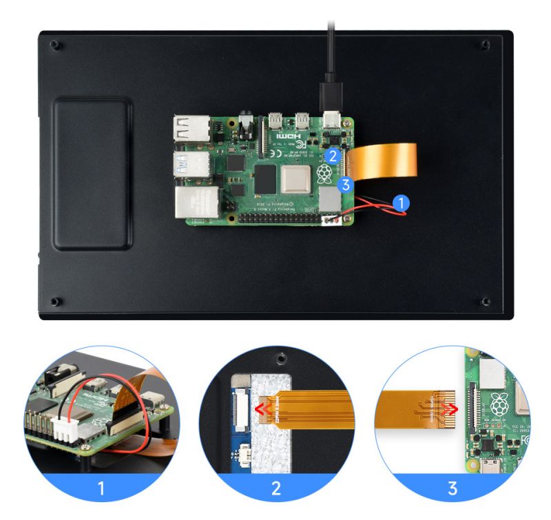

Pi5/CM5/CM4/CM3+/CM3 Hardware Connection
- Use the "FFC Cable 22PIN 200mm (opposite direction)" to connect the DSI port of the display to the 22PIN DSI port of the Raspberry Pi motherboard.
- Use the "GPIO cable" to connect the power connector of the display to the 5V GND pin header of the Raspberry Pi motherboard.
- Secure the Raspberry Pi to the display with M2.5 screws.
The installation effect is as follows:
Note: Make sure that the DSI cable is connected in the correct direction and 5V power is supplied through the GPIO pins.
Pi4B/3B+/3B/3A+ Hardware Connection
- Use the "DSI-Cable-12cm" cable to connect the DSI port of the display to the 15PIN DSI port of the Raspberry Pi motherboard.
- Secure the Raspberry Pi to the display with M2.5 screws. The installation effect is as follows:

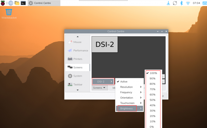

Adjust Backlight Brightness
GUI Backlight Adjustment

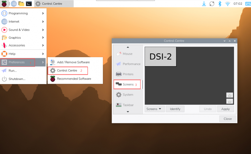

The following steps are based on the Trixie system:
- Click the menu in the upper left corner, then go to Preferences → Control Center, and select Screens;
- Go to "Screen" -> "DSI-2" -> "Brightness", check and adjust the desired backlight brightness, and finally click Apply to save the settings.
In the Bookworm system, this setting entry is located at Screen Configuration → Screen.

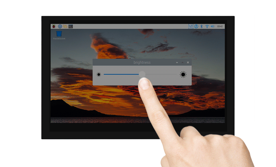

Use Waveshare Backlight Adjustment Application
You can also use the graphical backlight adjustment tool provided by Waveshare (this program is only for Trixie, Bookworm, and Bullseye systems):
wget https://files.waveshare.com/wiki/common/Brightness.zip
unzip Brightness.zip
cd Brightness
sudo chmod +x install.sh
./install.sh
After the installation is completed, you can open the demo in the Start Menu -> Accessories -> Brightness, as shown below:

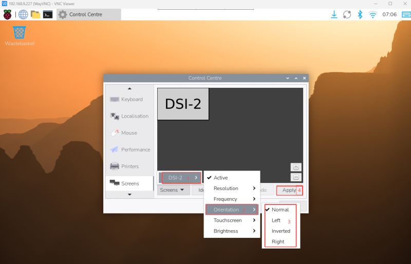

Trixie/Bookworm Display Rotation
GUI Interface Rotation

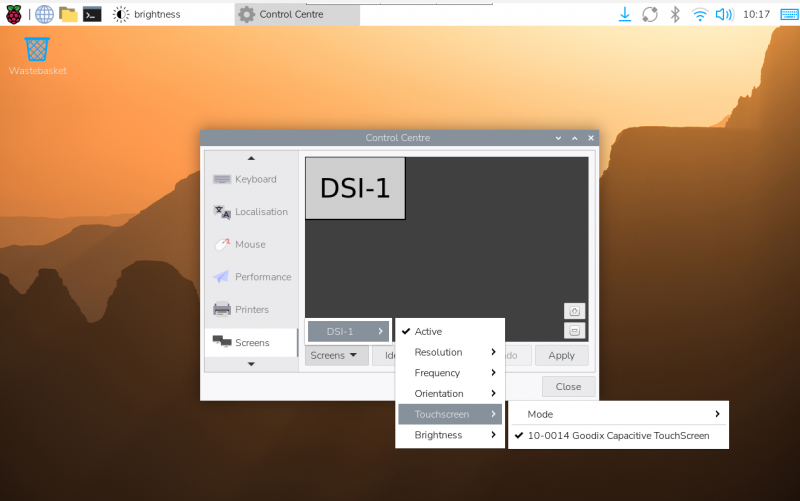

- Go to Screen - > DSI-1 - > Touchscreen and check "10-0014 Goodix Capacitive TouchScreen";
- Go to Screen -> DSI-2 -> Orientation, check the direction you need to rotate, and finally click "Apply" to complete the display and touch synchronous rotation.
- In the Bookworm system, this setting entry is located at Screen Configuration → Screen.
Note: Only Trixie/Bookworm systems support the above synchronous rotation methods. For Bullseye/Butser systems, after displaying rotation, touch rotation needs to be manually set separately.

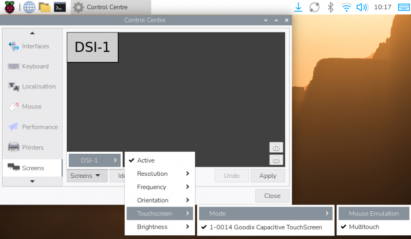

Touch Mode Selection
The systems after Bookworm support two touch modes, which can be switched in the Screen Configuration > Touchscreen menu:
1.Mouse Emulation (default)
Click = Left mouse button function
Long press = Right mouse button function
Supports double-click
Does not support page swiping and multi-touch functionality
Note: This mode is suitable for scenarios that require mouse operation, such as double clicking to open the file manager and long pressing to achieve right-click functionality.
2.Multitouch
Supports multi-touch functionality
Supports swiping pages
Does not support double-click and long-press right-click functions
Note: This mode is suitable for touch-optimized scenarios, such as web browsing and scrolling lists.

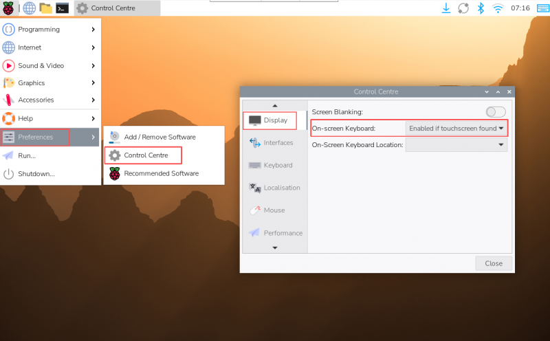

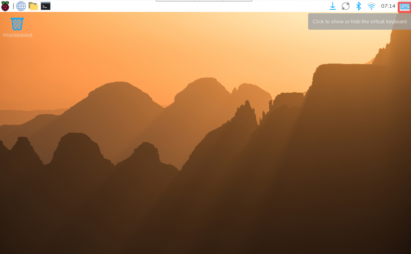

Use Touchscreen Virtual Keyboard
Raspberry Pi OS Bookworm and later versions include Squeekboard on-screen keyboard by default.
- The keyboard system will automatically pop up when text input is available and automatically hide when text input is not available.
You can also permanently set the display or hiding of the on-screen keyboard through the menu Preferences → Control Centre → Display in the upper left corner.
In the Bookworm system, you can set the keyboard to be displayed or hidden via Raspberry Pi Configuration → Display or raspi-config → Display.
Note:
For older versions of Raspberry Pi OS before Bookworm, please use matchbox-keyboard. If you are using the wayfire desktop compositor, use wvkbd.
