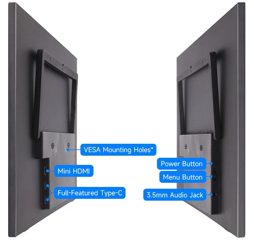

3.Interface

Power Button
  • Short press (outside menu): Open input source selection panel (Auto / Type-C / HDMI)
  • Short press (inside menu): Exit menu interface
  • Long press: Turn backlight on/off
🔴 **Note: **Normally, the screen will automatically turn on when a valid signal is detected after power on, no manual button press required.

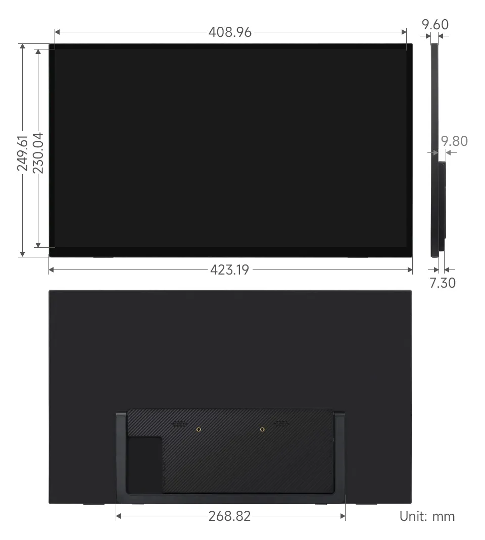

8. Dimensions

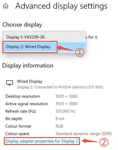

Q: How to enable 120Hz refresh rate in Windows?
💡: Generally, Windows will automatically detect and set the optimal resolution and refresh rate for your monitor. If it does not automatically set to 120Hz, please follow the steps below to adjust manually:
Adjust Windows Display Settings:
  • Go to Windows Display Settings, then select Advanced display settings.
  • In the Choose display dropdown menu, select the 18.5" Portable Monitor, then click Display adapter properties.

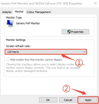

  • In the pop-up window, switch to the Monitor tab, select 120Hz from the Screen refresh rate dropdown menu. Click Apply and confirm the change.
