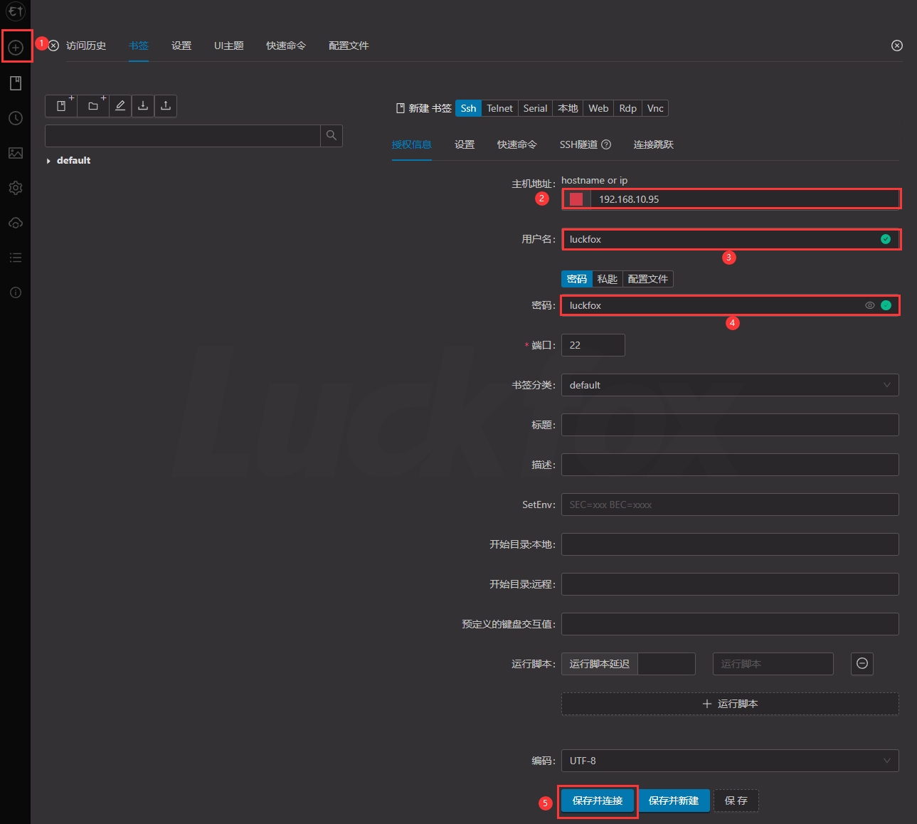

  1. SSH Login to the Development Board.

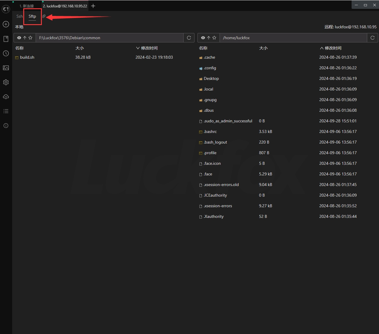

  2. File Transfer.
