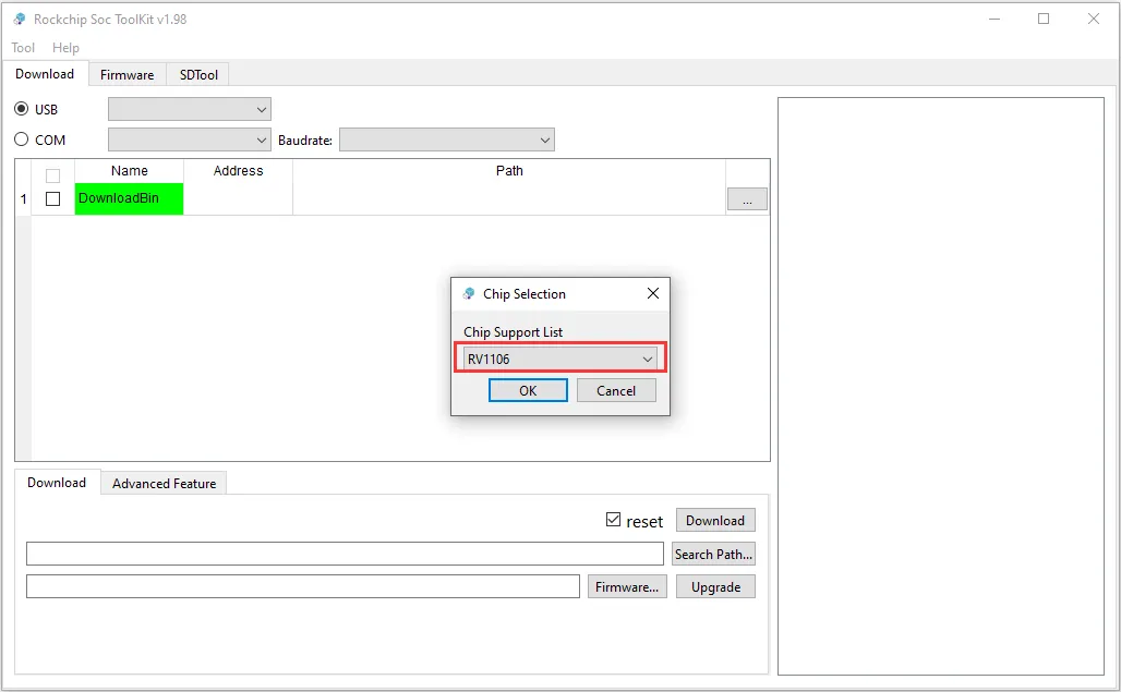

  2. Open the software(right-click and run as administrator),then select RV1106.

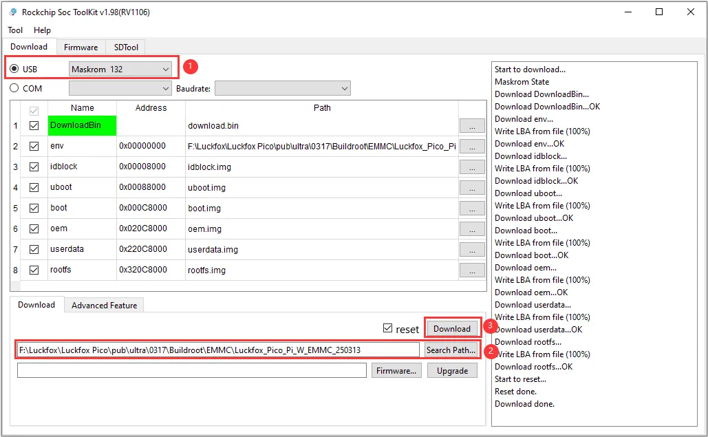

  1. Device connection and partition image flashing: ① Put the board into flashing mode. If the BOOT button is accessible, hold it down while connecting the board. If the board is already running and you can log in, run reboot loader. Continue after the tool displays a MaskRom or Loader device (device number may vary).
② Click Search Path to select the firmware directory, check all the partitions you want to flash, then click the Download button to start flashing.

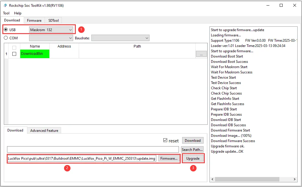

  1. Device connection and one-click full image flashing:
② Click Firmware to select the firmware directory, then click the Upgrade button to start flashing.

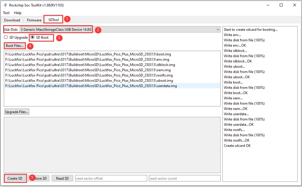

4.2 Flashing Image to TF Card
Tip
The SD card flashing feature of the SocToolKit software only supports one-click image flashing.
  1. Download the TF card formatting tool SD Card Formatter, unzip and install with one click.
  2. Select the correct TF card drive letter and click "Format". Make sure to remove any other TF cards to avoid accidental data loss.
  3. Download and extract the SocToolKit flashing tool.
  4. Open the software(Run as Administrator), then choose RV1106.
  5. Follow these flashing steps: ① Launch the SocToolKit tool and switch to SDTool mode. ② Insert the TF card into a reader and connect it to your PC. The SD card capacity should now be visible under USB drives. ③ Select SD Card Boot. ④ Import the boot files.(Note: The boot files do not include update.img) ⑤ Click Create SD Card to begin the flashing process.。
Warning
  1. If the MicroSD card is not recognized, please re-run the software with administrator privileges.
  2. The bootable image does not contain update.img.

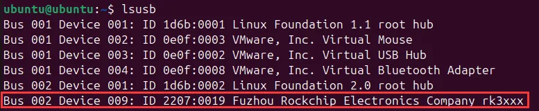

5.1.1 Entering Flash Mode on the Development Board

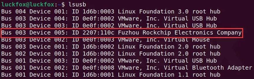

Press and hold the BOOT button while connecting the board to the host PC to enter flash mode. After running the lsusb command, you can compare the device recognition results between flash mode and normal operating mode, as shown below:
  • Board in flash mode:
  • Board successfully booted into the system:
Note
If the virtual machine cannot recognize the board, it is usually caused by one of the following reasons:
  1. Faulty USB cable: If replugging the cable causes no response and no system or VMware popup appears, the cable is likely damaged or has a poor connection. Try replacing the USB cable and reconnecting the board.
  2. Device not assigned in VMware popup: When plugging in the board, VMware will prompt you to choose whether to connect the device to the “Host” or “Virtual Machine.” If no selection is made before the popup disappears and VMware’s auto-connect policy is not properly configured, the device remains unassigned, meaning it is neither controlled by the host nor mounted to the VM. In this case, replug the device to reassign control.

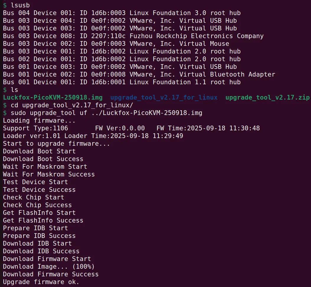

5.1.2 Flashing Standalone Image (Without SDK)
  1. Download, extract, and install upgrade_tool
sudo unzip upgrade_tool_v2.17.zip
cd upgrade_tool_v2.17_for_linux/
sudo cp upgrade_tool /usr/local/bin
sudo chmod +x /usr/local/bin/upgrade_tool
  1. Verify installation success:
ubuntu@ubuntu:~$ sudo upgrade_tool -v
Upgrade Tool v2.17
  1. Run the tool to flash the firmware:
luckfox@luckfox:~$ sudo upgrade_tool uf update.img

  1. Result preview:

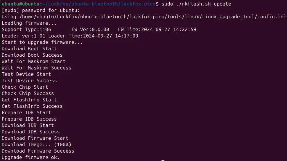

5.1.2 Flashing the Image via SDK Script
Note
The output/image directory must contain the update.img file, which is automatically generated when compiling the SDK. If you have not compiled the SDK yet, manually create the output/image directory and place the downloaded firmware inside it, renaming the file to update.img.
  1. Ensure the board is in flash mode before proceeding.
  2. Run the flashing script with administrator privileges:
$ sudo ./rkflash.sh update
[sudo] password for ubuntu:
Using /home/ubuntu/Luckfox/ubuntu-bluetooth/luckfox-pico/tools/linux/Linux_Upgrade_Tool/config.ini
Loading firmware...
Support Type:1106 FW Ver:0.0.00 FW Time:2024-09-27 14:22:59
Loader ver:1.01 Loader Time:2024-09-27 14:17:09
Start to upgrade firmware...
Download Boot Start
Download Boot Success
Wait For Maskrom Start
Wait For Maskrom Success
Test Device Start
Test Device Success
Check Chip Start
Check Chip Success
Get FlashInfo Start
Get FlashInfo Success
Prepare IDB Start
Prepare IDB Success
Download IDB Start
Download IDB Success
Download Firmware Start
Download Image... (100%)
Download Firmware Success
Upgrade firmware ok

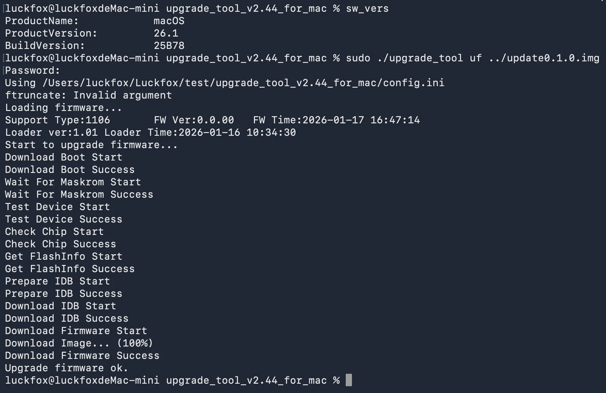

  1. Put the board into flashing mode using the method described at the beginning of the current product tutorial. For an enclosed Luckfox Pico 86-Panel that can boot normally, log in and run reboot loader.
  2. Run the tool to flash the firmware:
Note
The following command is only an example. Please modify the image file name and path according to the actual image file you are using.
cd upgrade_tool_v2.44_mac
sudo ./upgrade_tool uf Luckfox-xxx-xxx.img
  1. The result is shown below.
