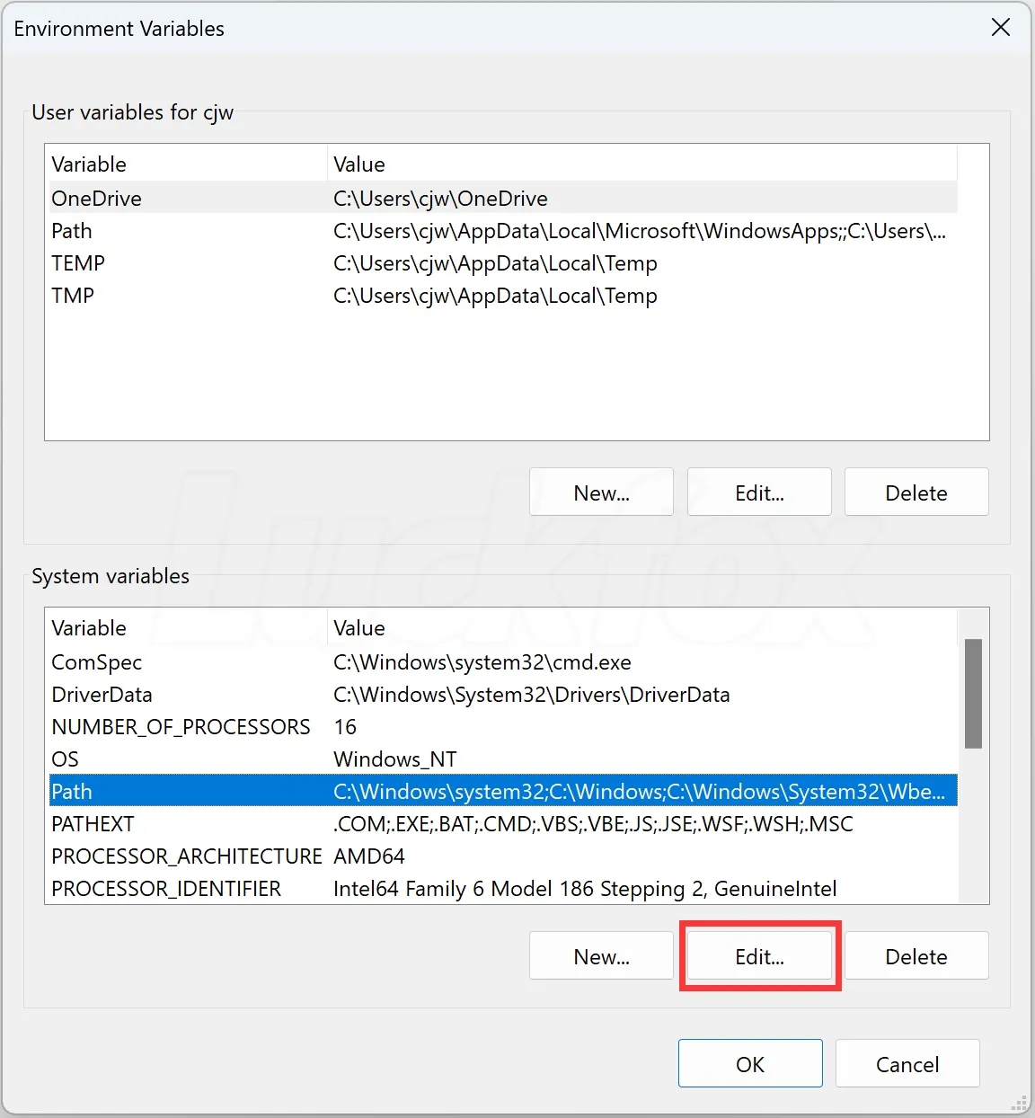

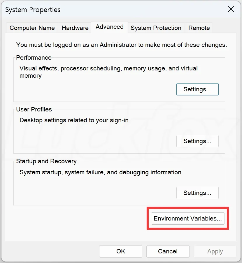

  2. Right - click on "This PC" and select "Properties"—>"Advanced system settings"—>"Environment variables".

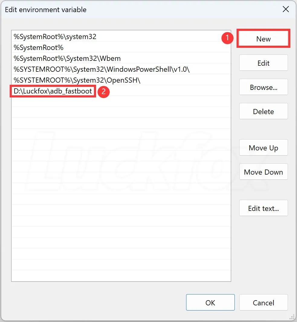

  1. In "System variables", click "Edit", then create a new entry with the extraction path of ADB.
  1. Click "OK" to save the environment variables.

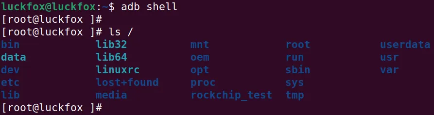

ADB Login

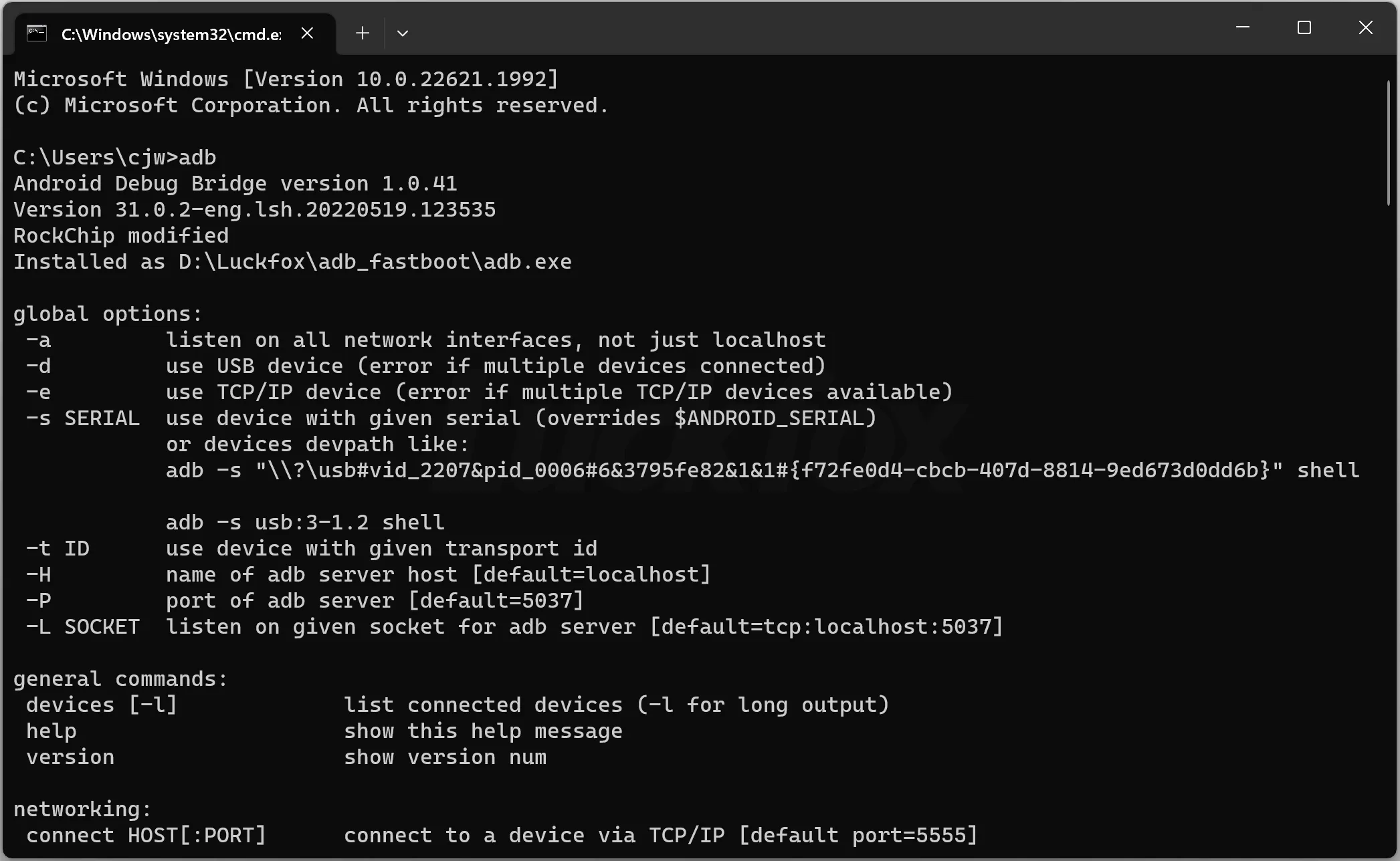

  1. Press the Win + R shortcut keys and enter "CMD" to open the Windows Terminal. Enter ADB commands in the terminal to view ADB - related information.
  1. If there is only one device, execute the commands in Powershell or CMD.
adb shell
  1. If multiple devices are connected, you can view the list of currently connected ADB devices through the following command:
adb devices
For example:
C:\Users\cjw> adb devices
List of devices attached
103ea97dececc831 device
d48936ed7d1551fc device
  1. After confirming the device, use the following command to log in to the development board via the device serial number:
adb -s d48936ed7d1551fc shell

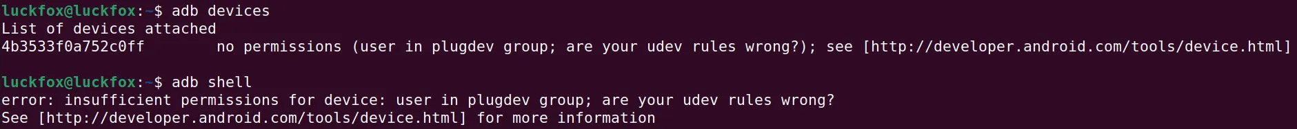

  1. If the correct udev rules are not configured, regular users will not be able to access USB devices. When using adb shell, errors such as "udev rules wrong" or insufficient permissions may appear.

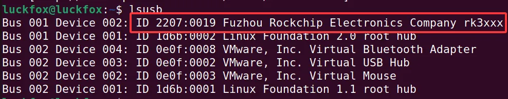

  1. Use thelsusbcommand to check the device ID.
  1. Create or edit a udev rules file:
sudo vim /etc/udev/rules.d/51-android.rules
  1. Add the following content to the file to grant read/write permissions to users in the plugdev group for devices with ID 2207:0019:
SUBSYSTEM=="usb", ATTR{idVendor}=="2207", ATTR{idProduct}=="0019", MODE="0666", GROUP="plugdev"
  1. After saving the file, change its permission:
sudo chmod 644 /etc/udev/rules.d/51-android.rules
  1. Reload the udev rules:
sudo udevadm control --reload-rules\nsudo service udev restart
  1. Reconnect the device: unplug and reinsert it to ensure the new rules take effect.

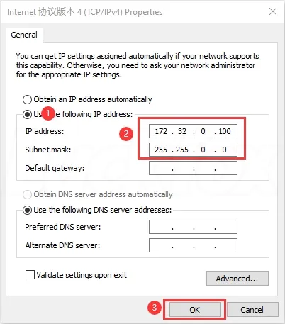

  1. Go to Windows Security Center—>Firewall & Network Protection—>Turn off the firewall.

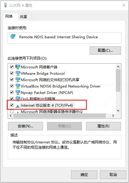

  1. Configure the RNDIS network interface with a static IP,Open Settings—>Advanced Network Settings —>Change Adapter Options.
  2. The network interface is usually named something like Remote NDIS based Internet Sharing Device. Right-click and select Properties.
  1. Double-click Internet Protocol Version 4 (TCP/IPv4), then set the IPv4 address to 172.32.0.100 to avoid conflicts with the board's IP.

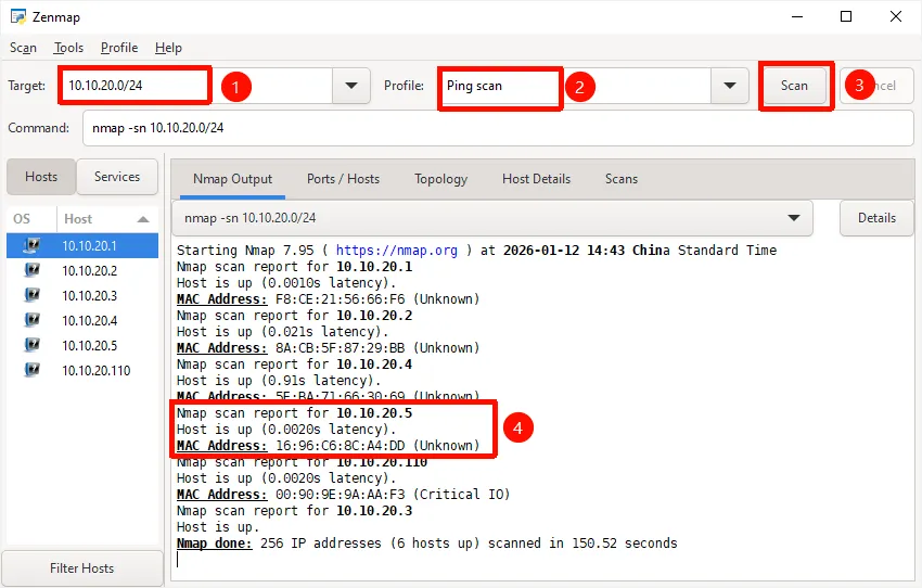

2.3.2 Dynamic IP Acquisition
Tip
To log in via Ethernet using a dynamic IP, simply connect one end of the Ethernet cable to the development board and the other end to a router. The board will obtain an IP address via udhcpc. Make sure the development board and your computer are on the same local network and that the SSH service is enabled (enabled by default). You can then log in via SSH using the obtained IP address.
  1. Download and install a LAN IP scanning tool(Click here to download).
  2. Run Zenmap, enter your network segment, select Ping scan, and click the Scan button to scan IP addresses on the local network.
  3. Record the current IP addresses.
  4. Power on the device and make sure it is connected to the network.
  5. Click the Scan button again to rescan the local network IP addresses.
  6. Exclude all previously recorded IP addresses. The remaining one is the IP address of the development board.

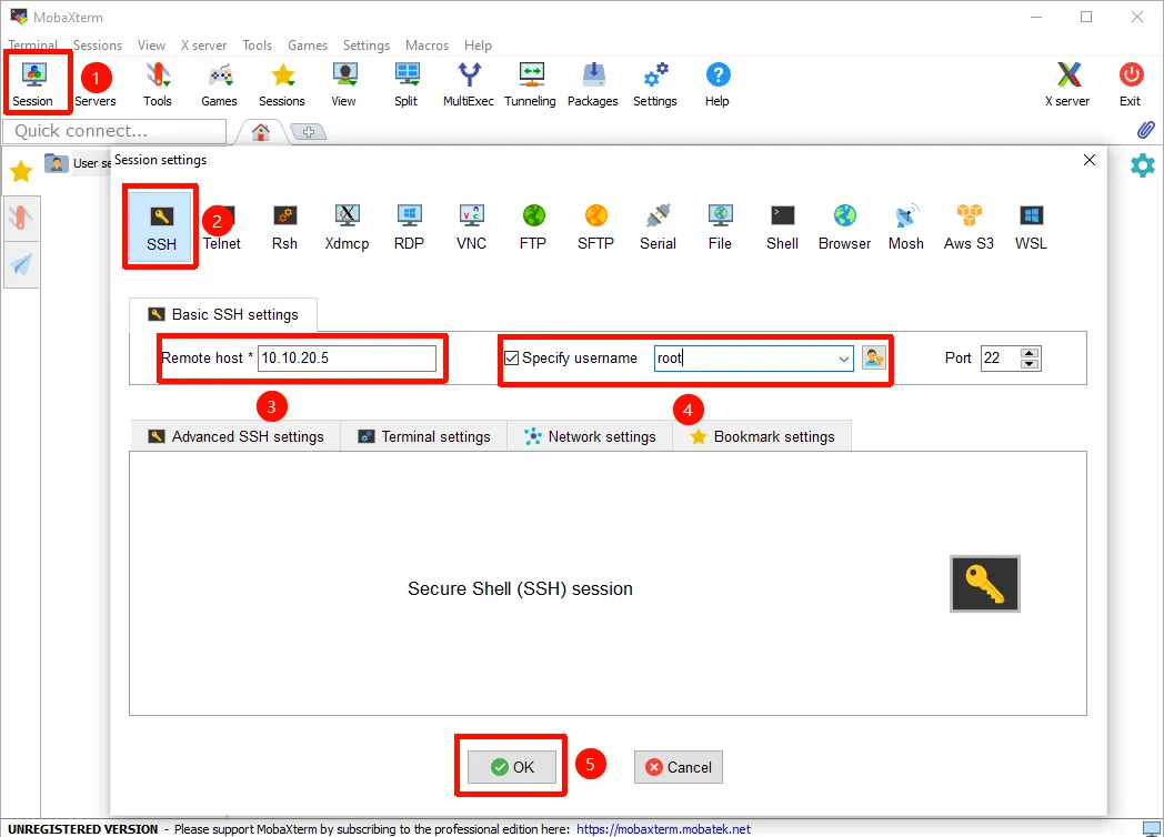

2.3.3 SSH Login
  1. Download the remote login tool and extract it for use. (Click here to download)

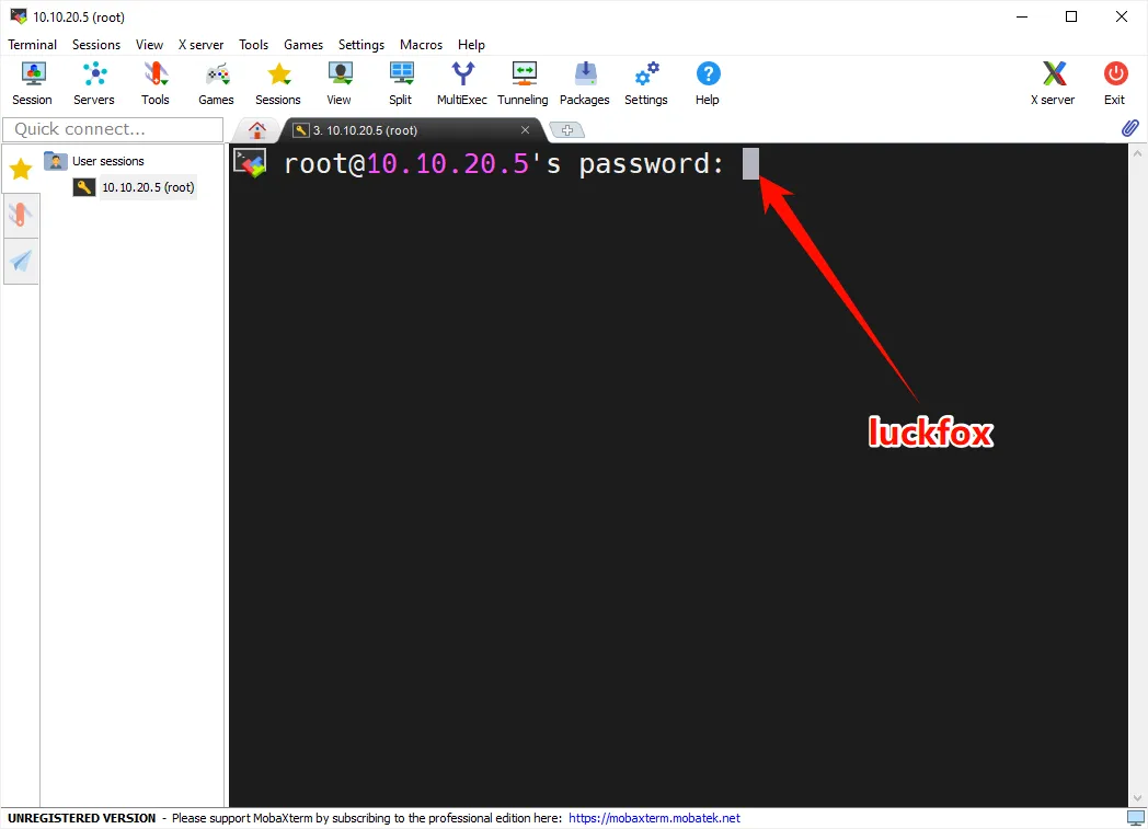

  2. Open the MobaXterm remote login tool, select Session → SSH, and enter the IP address obtained earlier (for example, 10.10.20.5) in the Remote host field. (Please replace it with your actual IP address.)
  1. After filling in the information, click OK, then enter the login username and password. Please refer to the Preparation section for the login credentials.
Tip
  • When entering the password, nothing will be displayed on the screen. This is normal. Press Enter after finishing the input to log in.

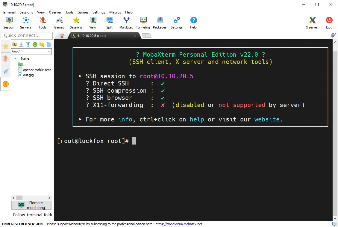

  1. You have now successfully logged in to the development board:

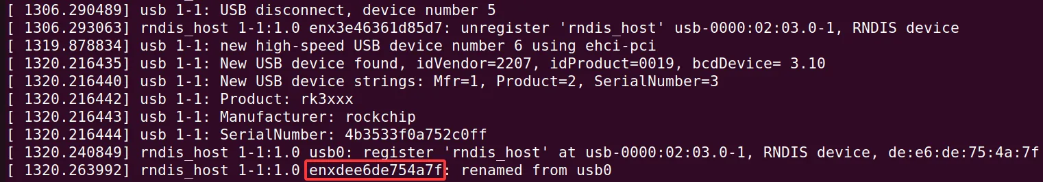

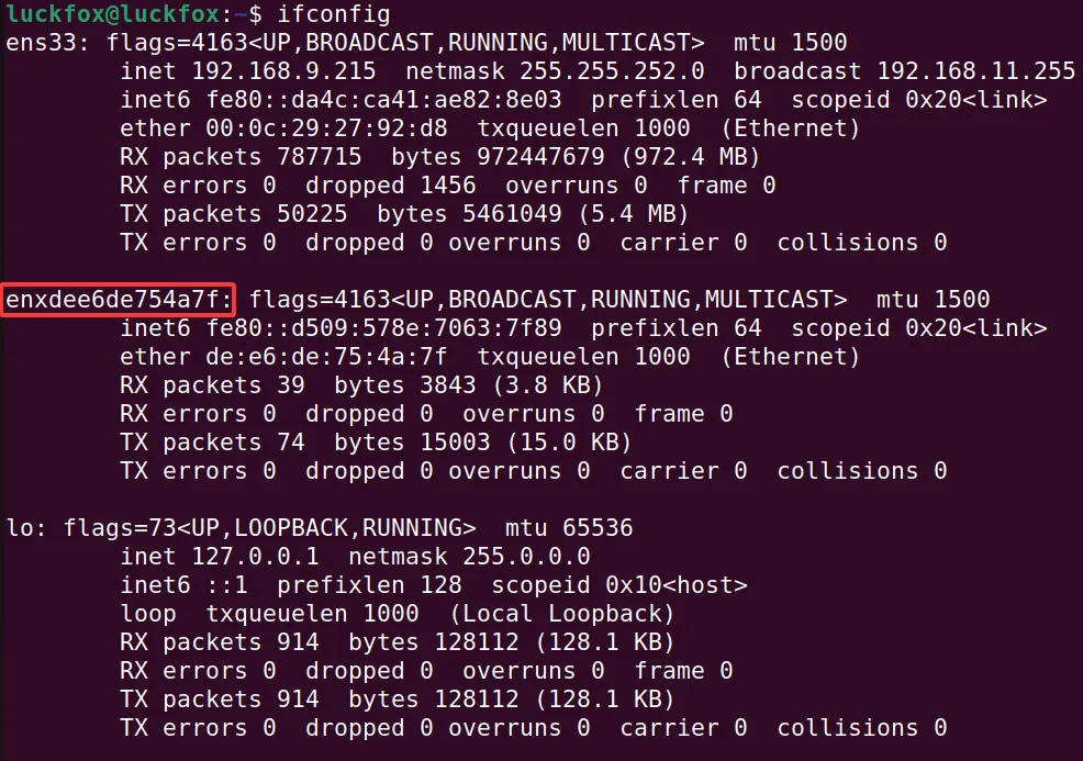

  1. After connecting the development board to an Ubuntu host or virtual machine, you can check the system log with the following command to confirm whether the RNDIS device has been successfully registered:
sudo dmesg | tail -n 50
  1. If the first step indicates that the RNDIS device was successfully registered, run the following command to view the newly created network interface:

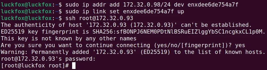

  1. Configure RNDIS:
sudo ip addr add 172.32.0.98/24 dev enxdee6de754a7f
sudo ip link set enxdee6de754a7f up
  1. Reconnect the device—unplug it and plug it back in—to ensure the new rules take effect.

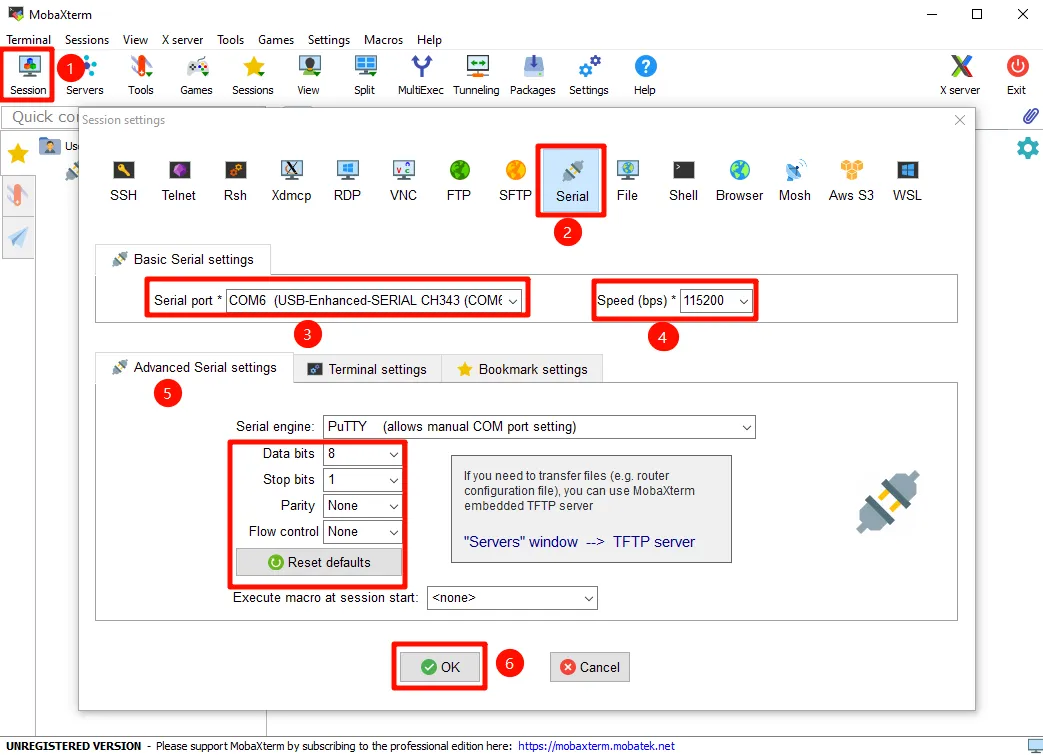

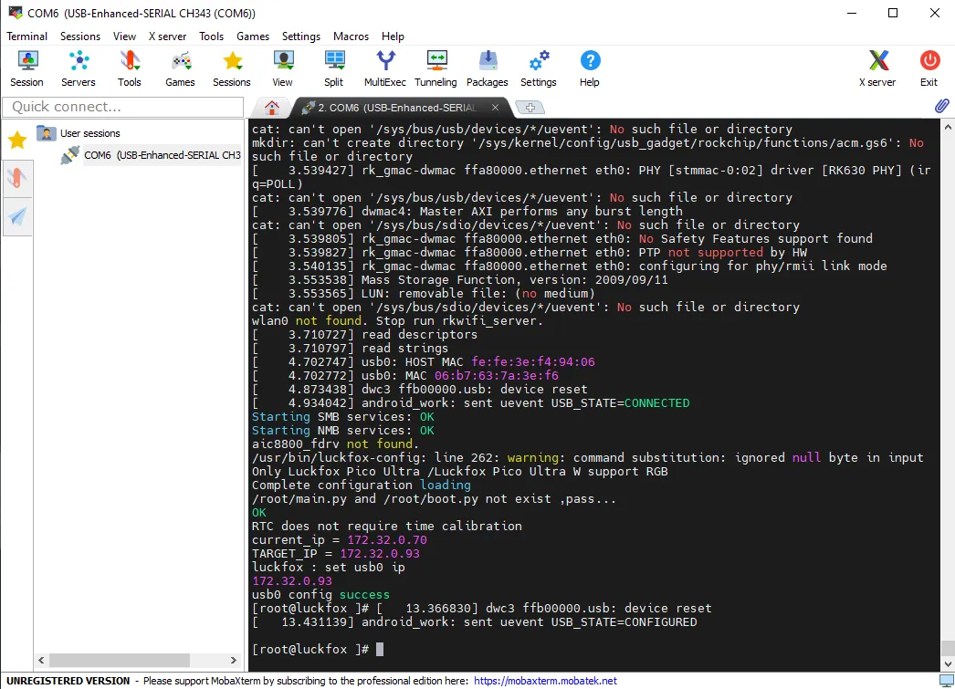

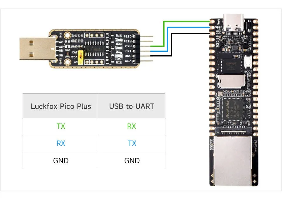

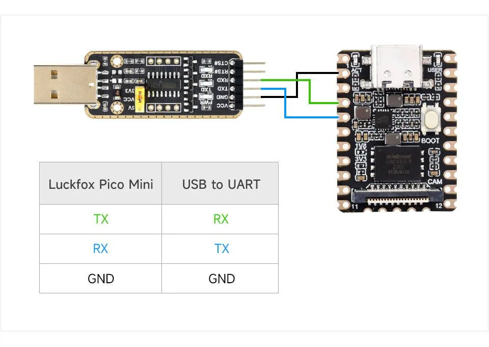

2.5 串口登录

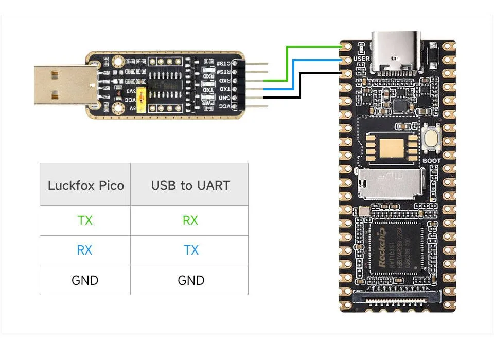

First connect one end of the USB-to-serial module to the computer, and connect the other end to the TX, GND, and RX pins of Luckfox Pico Pro/Max, as shown below:

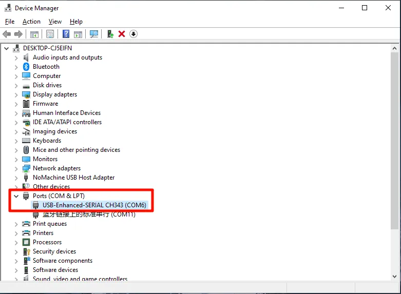

  1. Download a serial login tool and extract it for use.( Click here to download ).
  2. Open your computer's settings, search for Device Manager, and check the COM port number assigned to the serial device. Take note of it.
  1. In the serial tool, go to Session → Serial, and set the baud rate to 115200.
  1. Click OK, then press Enter, and input the login name and password to log in.
