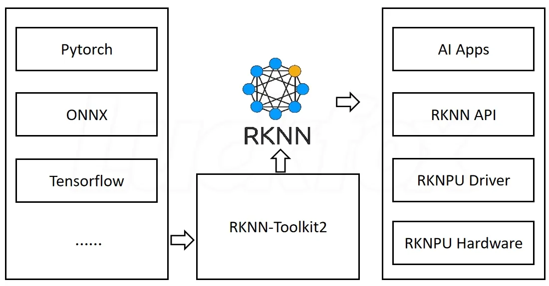

2. Introduction to RKNN-Toolkit2
RKNN-Toolkit2 provides C or Python interfaces on the PC platform to simplify the deployment and execution of models. Users can easily accomplish the following tasks with this tool: model conversion, quantization, inference, performance and memory evaluation, quantization accuracy analysis, and model encryption. The RKNN software stack assists users in deploying AI models to Rockchip chips quickly. The overall framework is as follows:
To use RKNPU, users need to first run the RKNN-Toolkit2 tool on their computer to convert the trained model into the RKNN format model, and then deploy it on the development board using the RKNN C API or Python API. This section introduces how users can quickly use RKNPU on the Luckfox Pico series boards.

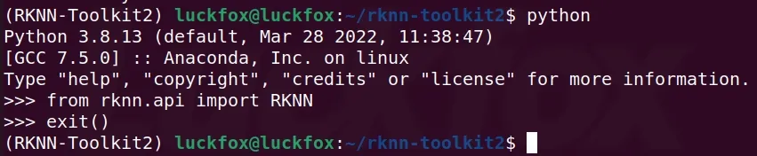

  1. Verify if the installation is successful. If there are no errors reported, the installation is successful.
python
>>> from rknn.api import RKNN

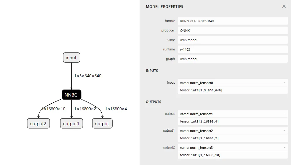

5.4 Model Verification
5.4.1 Preliminary Analysis of the Model
The internal structure of the output RKNN model cannot be parsed by Netron tool, but basic information about inputs and outputs can be examined for initial assessment.
  • luckfox-pico only supports int8 type inputs and outputs
If the converted model has float type input and output tensor structures, data may not be correctly retrieved, necessitating a re-adjustment of the model structure.
  • luckfox-pico only supports 4-dimensional input and output dimensions

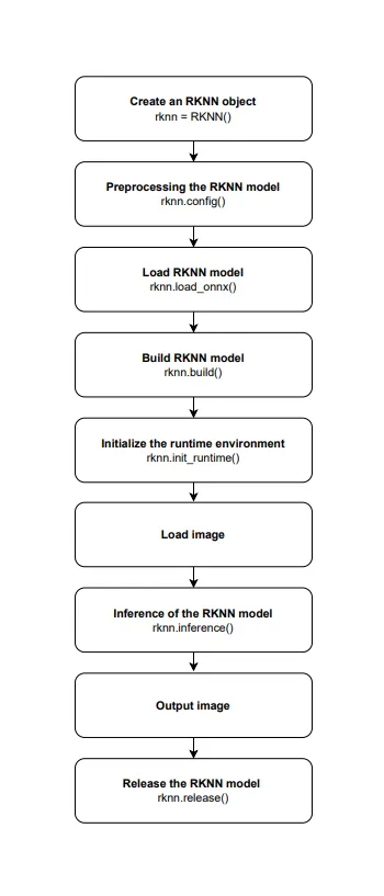

5.4.2 Software Simulator Model Verification
Currently, luckfox-pico only supports model inference using the C-API on the board. However, during the model verification phase, the RKNN-Toolkit2 Python interface can be used to run tests on a software simulator, leveraging Python's rich third-party libraries to write test programs. The process of model verification using RKNN-Toolkit2.
  1. Create RKNN object
rknn = RKNN()
  1. Preprocessing configuration. Configure according to the image preprocessing code in the model training source code.
rknn.config(mean_values=[[0, 0, 0]], std_values=[[128, 128, 128]],
target_platform='rv1103',
quantized_algorithm="normal")
  1. Load the model
rknn.load_onnx(model = model_path)
  1. Build the model
rknn.build(do_quantization=do_quant, dataset=DATASET_PATH)
  1. Initialize runtime environment. Passing the target parameter will use the adb tool to remotely control model inference on the board. By default, without passing parameters, model inference is performed on the software simulator.
rknn.init_runtime()
  1. Input and output processing. Depending on the third-party library used, there are different ways to handle input and output. Refer to the processing methods in the model training source code.
  2. Release the RKNN object
rknn.release()
  • Output data from the software simulator model inference can be compared with the input and output data from the board's model inference to determine if the model deployment environment is correct.

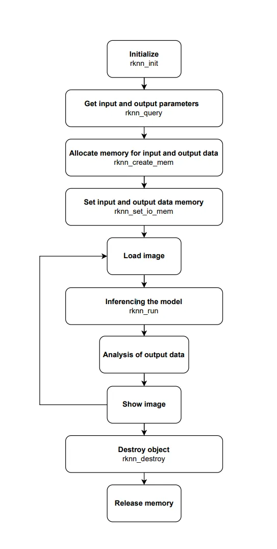

5.5 Application Design
The application flow for AI model inference
  1. RKNN initialization
  • During RKNN initialization, system memory allocation or custom memory allocation can be chosen based on the model's memory usage. System memory allocation is recommended for general models.
rknn_init(&ctx, mode_path, 0, 0, NULL);
  • If multiple models need to be run sequentially and memory resources are tight, custom memory allocation can be used to allow intermediate tensor memory reuse between two models. Memory allocation should be released promptly when using this method.
rknn_context ctx_a, ctx_b;
rknn_init(&ctx_a, model_path_a, 0, RKNN_FLAG_MEM_ALLOC_OUTSIDE, NULL);
rknn_query(ctx_a, RKNN_QUERY_MEM_SIZE, &mem_size_a, sizeof(mem_size_a));
rknn_init(&ctx_b, model_path_b, 0, RKNN_FLAG_MEM_ALLOC_OUTSIDE, NULL);
rknn_query(ctx_b, RKNN_QUERY_MEM_SIZE, &mem_size_b, sizeof(mem_size_b));
max_internal_size = MAX(mem_size_a.total_internal_size, mem_size_b.total_internal_size);
internal_mem_max = rknn_create_mem(ctx_a, max_internal_size);
internal_mem_a = rknn_create_mem_from_fd(ctx_a, internal_mem_max->fd, internal_mem_max->virt_addr, mem_size_a.total_internal_size, 0);
rknn_set_internal_mem(ctx_a, internal_mem_a);
internal_mem_b = rknn_create_mem_from_fd(ctx_b, internal_mem_max->fd, internal_mem_max->virt_addr, mem_size_b.total_internal_size, 0);
rknn_set_internal_mem(ctx_b, internal_mem_b);
  1. Getting input and output parameters of the RKNN model
// Get the number of input and output channels
rknn_query(ctx, RKNN_QUERY_IN_OUT_NUM, &io_num, sizeof(io_num));
// Get parameters of each input channel
rknn_query(ctx, RKNN_QUERY_NATIVE_INPUT_ATTR, &(input_attrs[i]), sizeof(rknn_tensor_attr));
// Get parameters of each output channel
rknn_query(ctx, RKNN_QUERY_NATIVE_OUTPUT_ATTR, &(output_attrs[i]), sizeof(rknn_tensor_attr));
  1. Memory allocation and setting for input and output of the RKNN model
// Allocate memory for each input channel
rknn_tensor_mem* input_mems[i] = rknn_create_mem(ctx, input_attrs[i].size_with_stride);
// Set memory for each input channel
rknn_set_io_mem(ctx, app_ctx->input_mems[i], &input_attrs[0]);
// Allocate memory for each output channel
rknn_tensor_mem* output_mems[i] = rknn_create_mem(ctx, output_attrs[i].size_with_stride);
// Set memory for each output channel
rknn_set_io_mem(ctx, app_ctx->output_mems[i], &output_attrs[i]);
  1. Input image
  • The instance uses OpenCV-Mobile to capture camera data from the SC3336 camera. By default, the color channel order is B-G-R, stored in cv::Mat format, which needs to be converted to the required input format for the model.
// Capture camera image
cap >> bgr;
// Resize to the required size by the model
cv::resize(bgr, bgr, cv::Size(width,height), 0, 0, cv::INTER_LINEAR);
for (int y = 0; y < height; ++y) {
for (int x = 0; x < width; ++x) {
cv::Vec3b pixel = bgr.at<cv::Vec3b>(y, x);
src_image[(y * width + x) * channels + 0] = pixel[2]; // Red
src_image[(y * width + x) * channels + 1] = pixel[1]; // Green
src_image[(y * width + x) * channels + 2] = pixel[0]; // Blue
// Copy data to the virtual address of the input tensor
memcpy(input_mems[0]->virt_addr, src_image,width*height*channels);
  1. RKNN model inference
  • luckfox-pico uses zero-copy API. After calling the rknn_run interface, output data will be synchronized to the virtual address of the set output memory.
rknn_run(ctx,nullptr);
  1. Output data analysis and processing
  • luckfox-pico's RKNPU only supports integer type outputs. RKNN models quantize both input and output data, so output data from luckfox-pico needs to be converted back to the original format before quantization before any further processing.
float deqnt = ((float)qnt - (float)zp) * scale;
  • If the model has been pruned in the training phase, CPU computation needs to use the format-converted output data. For example, in Facenet, the final normalization process was removed from the ONNX model export to make it compatible with RKNPU. Therefore, after format conversion, normalization needs to be added to the output data.
float sum = 0;
for(int i = 0; i < 128; i++)
sum += out_fp32[i] * out_fp32[i];
float norm = sqrt(sum);
out_fp32[i] /= norm;

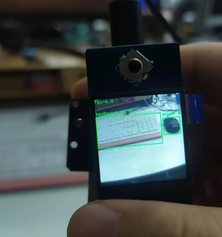

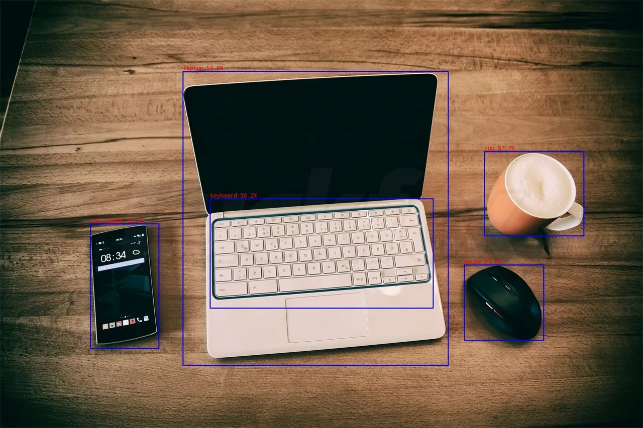

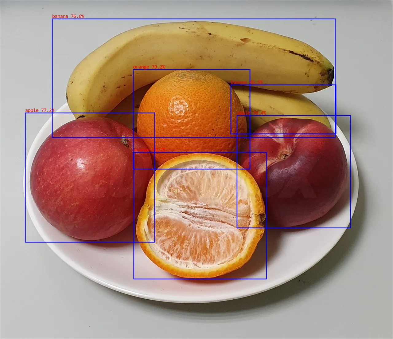

5.6.3 Example Results
The examples provide source code for object recognition and face recognition, which can be used as a reference for deploying other AI models. Both examples use the opencv-mobile driver to capture images from the sc3335 camera and display the processed results on the screen.
  1. The face recognition example uses the RetinaFace model for face detection and the FaceNet model for face feature extraction, comparing with the reference face to calculate the Euclidean distance (the difference in feature values; a smaller value indicates a higher match).
  1. The object recognition example uses the Yolov5 convolutional neural network model to identify 80 types of objects and display their confidence scores.
6. RKNN_Model_Zoo Application Example
rknn_model_zoo provides deployment examples for various mainstream algorithms supported by RKNPU. Currently, there is limited support for the RV1103/RV1106 used in Luckfox Pico. The latest examples support deploying Mobilenet and YOLO models. This section introduces the use of rknn_model_zoo examples with Yolov5 deployment.
6.1 Export RKNN Model
  1. Download rknn_model_zoo
git clone https://github.com/airockchip/rknn_model_zoo.git
  1. Obtain Yolov5 ONNX model file
cd <rknn_model_zoo Path>/rknn_model_zoo/examples/yolov5/model
chmod a+x download_model.sh
./download_model.sh
  1. xecute the model conversion program convert.py in the rknn_model_zoo/examples/yolov5/python directory. Usage:
conda activate RKNN-Toolkit2
cd <rknn_model_zoo Path>/rknn_model_zoo/examples/yolov5/python
python3 convert.py ../model/yolov5s.onnx rv1106
# output model will be saved as ../model/yolov5.rknn
python3 convert.py <onnx_model> <TARGET_PLATFORM> <dtype(optional)> <output_rknn_path(optional)>

6.4 Experimental Results
  • Fruit inference test
  • Multi-object scene inference test
