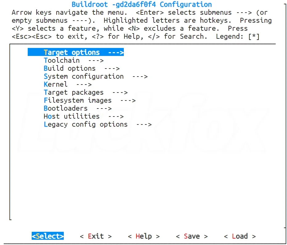

  1. Open the configuration interface. Enter the SDK root directory and start the Buildroot configuration interface. If the SDK has not been compiled before, select the corresponding branch for your development board first:
    cd luckfox-pico
    ./build.sh lunch
    ./build.sh buildrootconfig

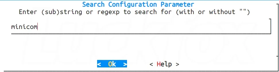

  2. Press /, enter minicom, and press Enter to search.

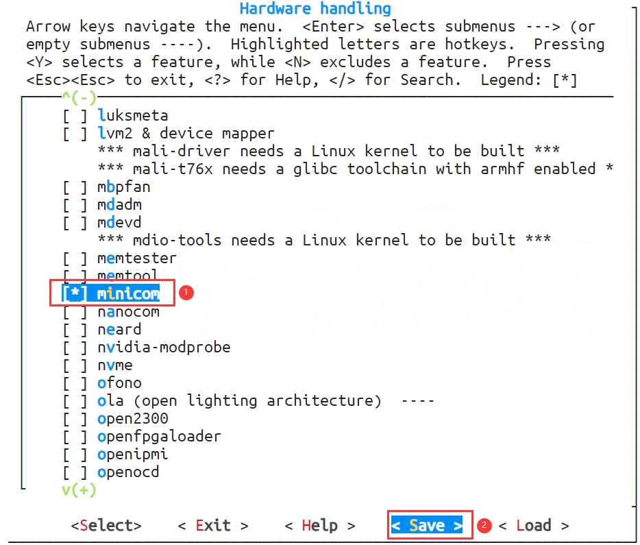

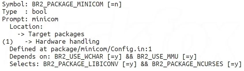

  3. If there is only one matching result, press 1 to jump to that configuration item.

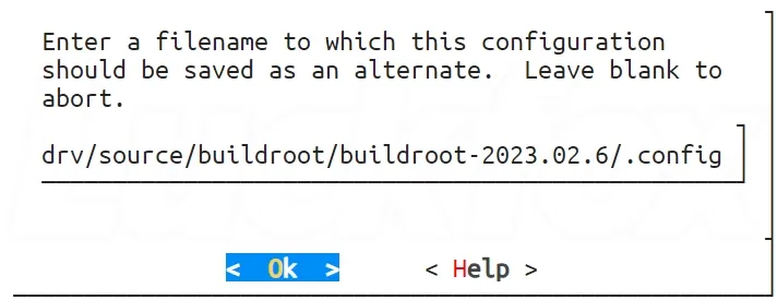

  4. Press Y or Space to select minicom, then choose Save to save the configuration.
  5. Select OK, then press Esc twice to exit.

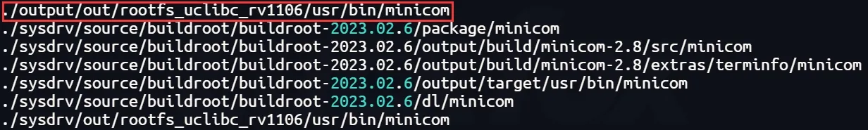

  6. Compile the image. After compilation succeeds, use the find command to check that minicom has been successfully integrated into the root filesystem:
    ./build.sh
    find -name minicom
