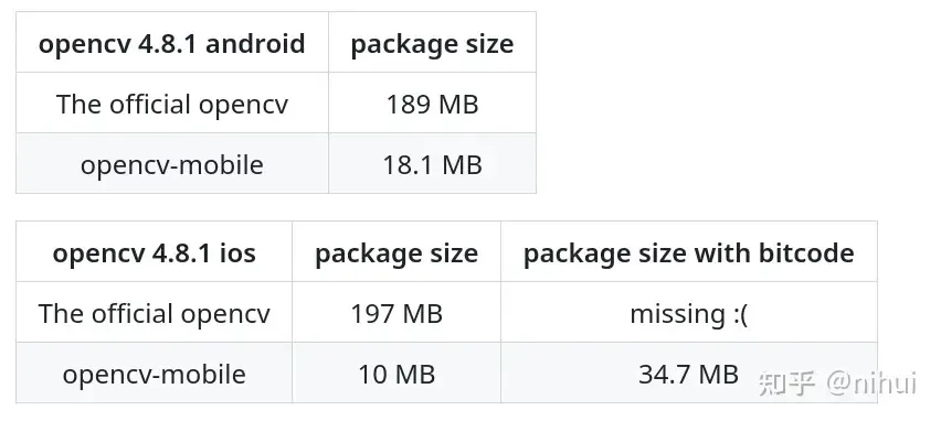

1.1 opencv-mobile
https://github.com/nihui/opencv-mobilegithub.com/nihui/opencv-mobile
opencv-mobile minimizes the compiled OpenCV library by adjusting compilation parameters and removing parts of the OpenCV source code.
It provides common OpenCV functionality such as image reading and writing, image processing, matrix operations, etc. It is version-synced with the upstream and has no third-party dependencies.
In most cases, it seamlessly replaces the official OpenCV library with only 1/10 of the size, making it particularly suitable for mobile and embedded environments with special size requirements.

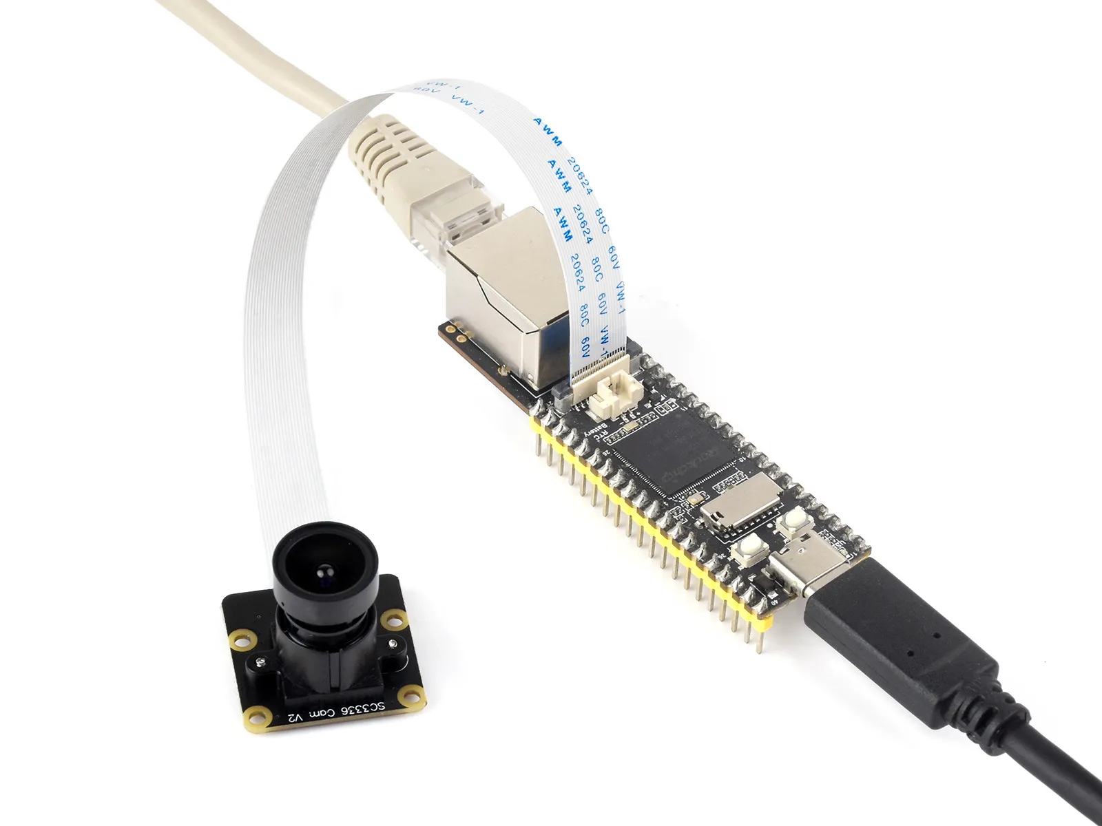

1.2 luckfox-pico
LuckFox Pico series is a low-cost micro Linux development board based on the Rockchip RV1103/RV1106 chip. RV1103/RV1106 is an AI application processor SoC for vision processing, featuring a single-core ARM A7 and built-in NPU with computing power up to 0.5TOPs.

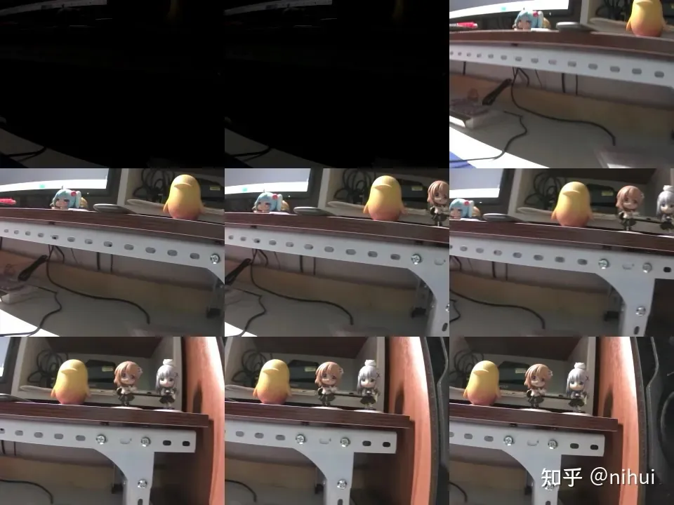

3. Camera Testing and Saving Frame Images
  • Use cv::VideoCapture to open the camera and set the resolution to 320x240.
  • Capture one frame every 1 second.
  • Close the camera.
  • Concatenate the nine frames and save them as a single image (cv::imwrite benefits from rkmpp acceleration!).
  • The first two frames at the beginning are very dark because rkaiq is still gathering image information and hasn't had time to automatically process ISP.

    bgr[0].copyTo(out(cv::Rect(0, 0, w, h)));
    bgr[1].copyTo(out(cv::Rect(w, 0, w, h)));
    bgr[2].copyTo(out(cv::Rect(w * 2, 0, w, h)));
    bgr[3].copyTo(out(cv::Rect(0, h, w, h)));
    bgr[4].copyTo(out(cv::Rect(w, h, w, h)));
    bgr[5].copyTo(out(cv::Rect(w * 2, h, w, h)));
    bgr[6].copyTo(out(cv::Rect(0, h * 2, w, h)));
    bgr[7].copyTo(out(cv::Rect(w, h * 2, w, h)));
    bgr[8].copyTo(out(cv::Rect(w * 2, h * 2, w, h)));
    cv::imwrite("out.jpg", out);
After running, you get out.jpg:
