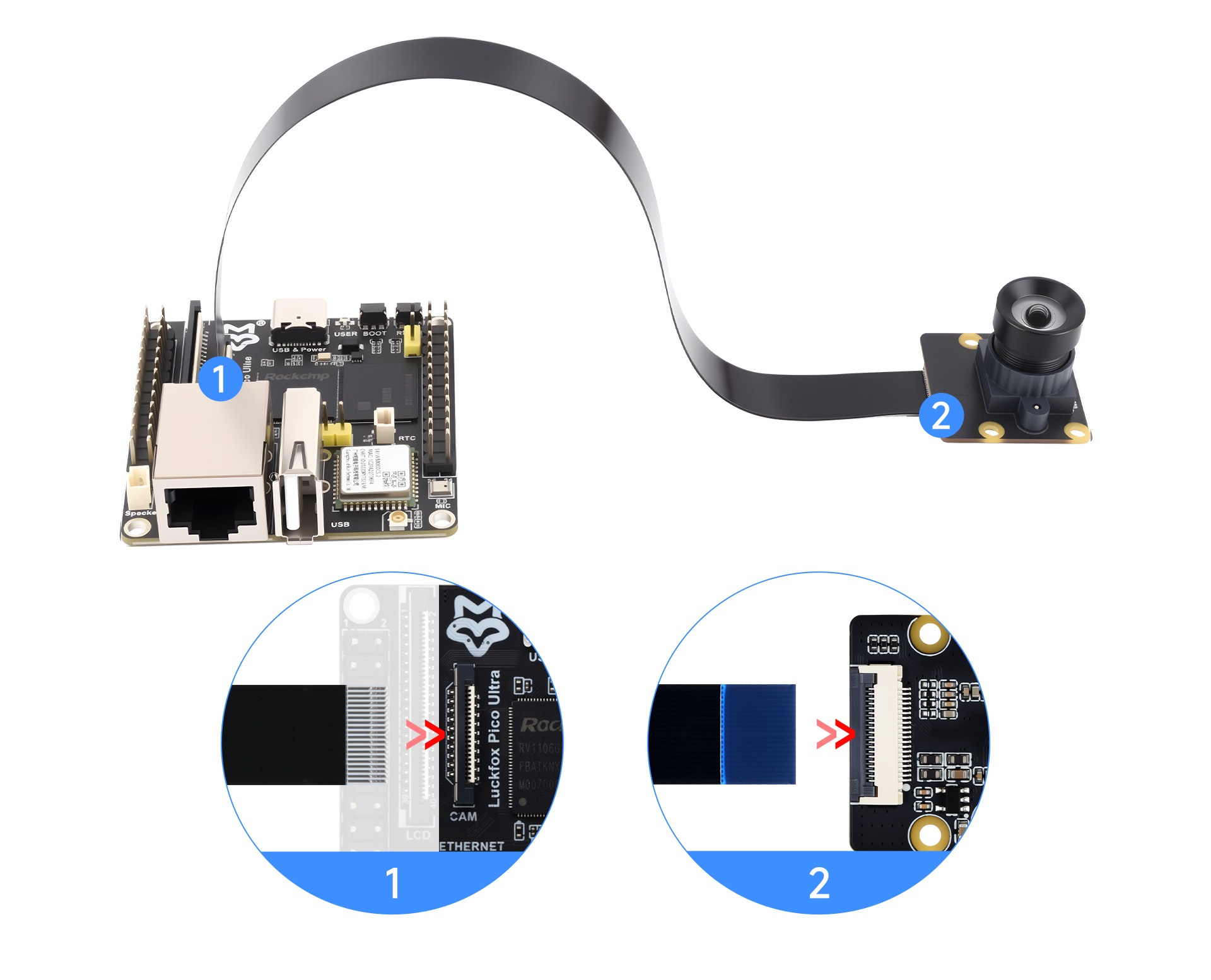

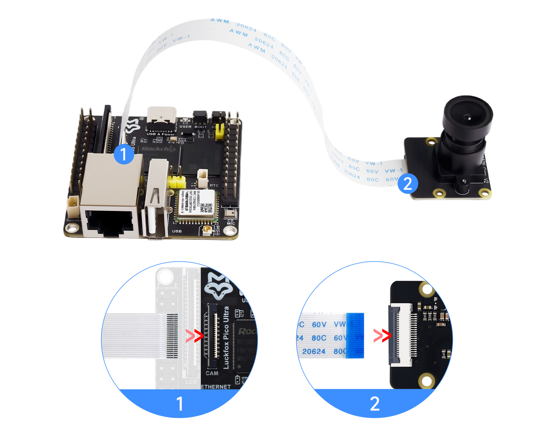

1. Hardware Connection
Luckfox Pico Ultra series: The metal side of the ribbon cable should face the chip side of the board.
xxxxxx
2. Checking the Camera and IP Address
Note: The orientation of the text on the blue ribbon cable from the factory may vary. Regardless of the text direction, just ensure that the metal side of the camera ribbon cable faces the RV1106. Please verify that the connection is proper before powering on.
