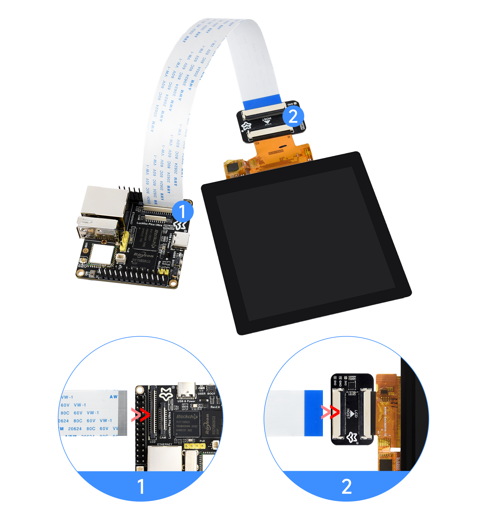

Quick Start
Hardware Connection
  • Luckfox Pico Ultra: If connecting to LP40-720720-ARK, check if a resistor is soldered at the following position. If it is, it must be removed. LP40-480480-ARK does not require checking for this resistor.
  • The screen is not connected to the FFC cable, and the specific connection steps are as follows:
    ① Lift the black latch on the adapter board upward.
    ②Insert the FFC ribbon cable with the metal side facing down into the adapter board.
    ③Lock the latch.
    Note: If the screen cannot display properly (e.g., with ripples), check if the FFC cable connection is secure. You may need to reinsert it to ensure proper contact.
  • Screen: Connect the screen to Luckfox Pico Ultra as shown in the diagram.xxx
    Note: Ensure power is off when connecting the screen. Before powering on, double-check the connection. Incorrect connections may damage the screen or Luckfox Pico Ultra.
