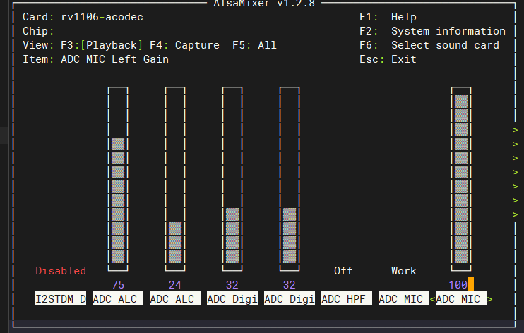

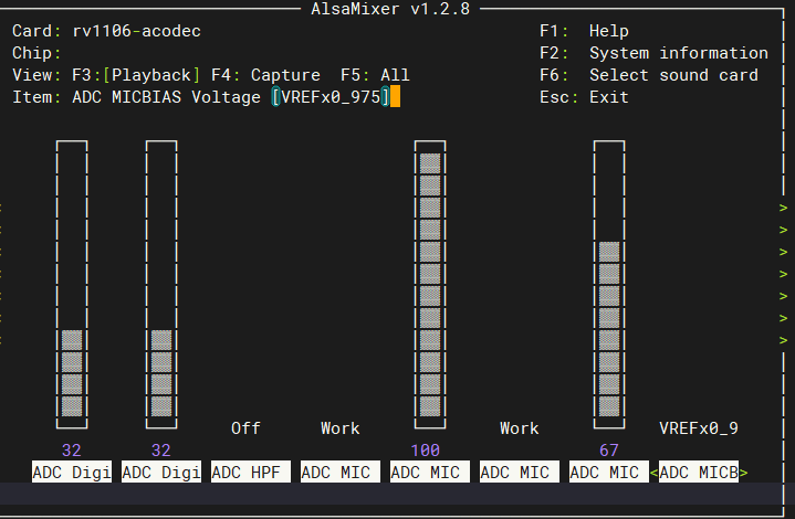

  1. Use the alsamixer command to increase the microphone's pickup range.
    • Increase ADC ALC Left Gain to 75.
    • Increase ADC MIC Left Gain to 100.
    • Increase ADC MICBIAS Voltage [VREFx0_975] to raise the bias voltage (critical).
    • Set ADC Mode [SingadcL] to digital collection.
