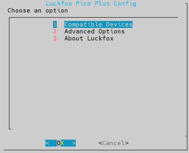

  1. Open the luckfox-config tool in the terminal:
luckfox-config

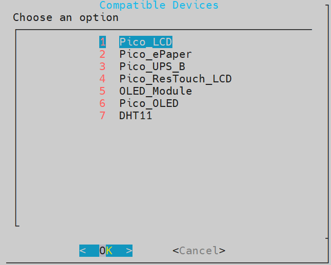

  1. Select Compatible Devices:
  1. Select Pico_LCD:
  1. Choose Yes, and after selecting, press Enter to confirm, then press Esc to exit:
  1. Reboot the development board.
