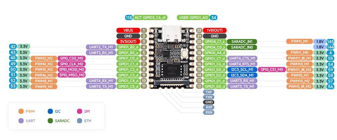

2.1 Pinout
Development boards typically come with enabled ADC interfaces, with a measurement range of 0V to 1.8V. We can see from the pinout diagram that four development boards have ADC interfaces corresponding to pin numbers 144 and 145.
  1. LuckFox Pico Diagram:
  2. LuckFox Pico Mini A/B Diagram:
  3. LuckFox Pico Plus Diagram:

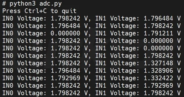

  1. Use the vi tool in the terminal to create a Python file, paste the Python program, and save it.
    # nano adc.py
  2. Run the program.
    # python3 adc.py
  3. Experimental Observations
    Obtain ADC dual-channel voltage values:

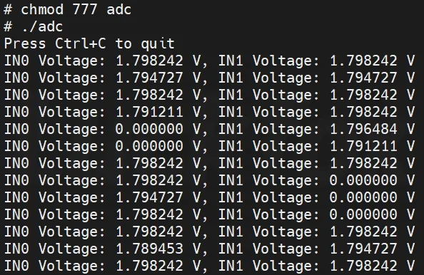

  2. Running the Program
    Modify the permissions of the adc file and then run the program:
    # chmod 777 adc
    # ./adc
    Obtain the voltage values of the ADC dual channels:
