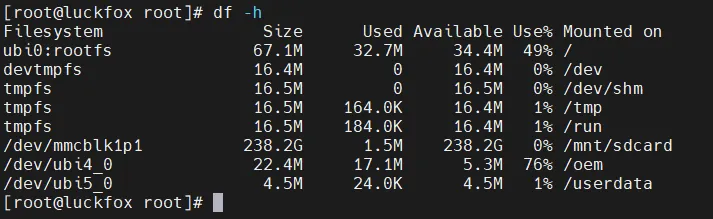

Note: The SDMMC disable configuration can take effect without rebooting, but the enable configuration requires a reboot to take effect.
Use the
dfcommand to check.
