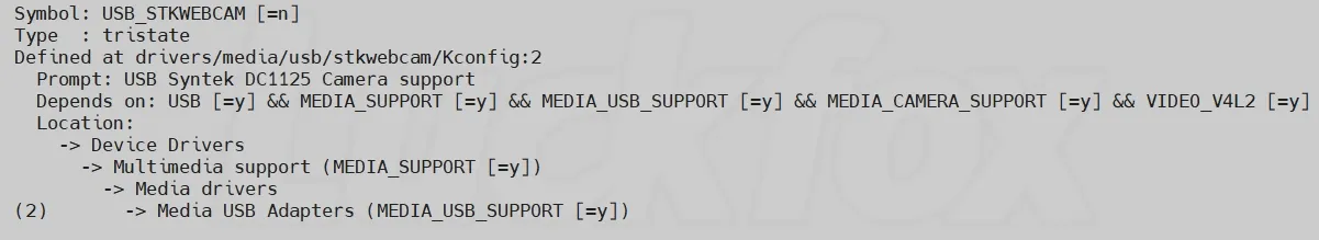

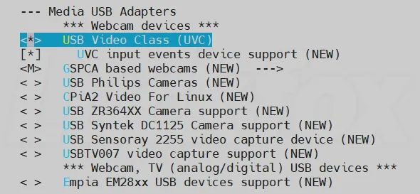

  1. Enable the UVC driver in the kernel by searching for the keyword "Webcam".
  2. In the search results, find and select "USB Video Class (UVC)", then save and exit.
  3. Compile the kernel and test if the UVC driver is loaded successfully.

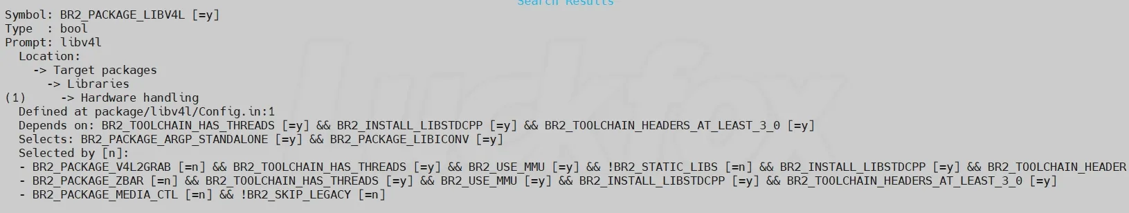

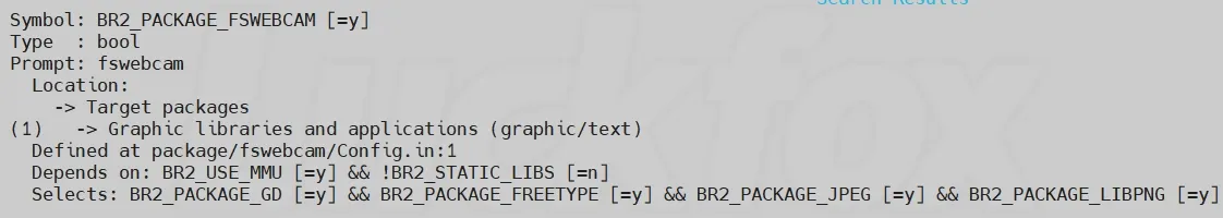

  1. Compile the kernel and test if the UVC driver is loaded successfully.

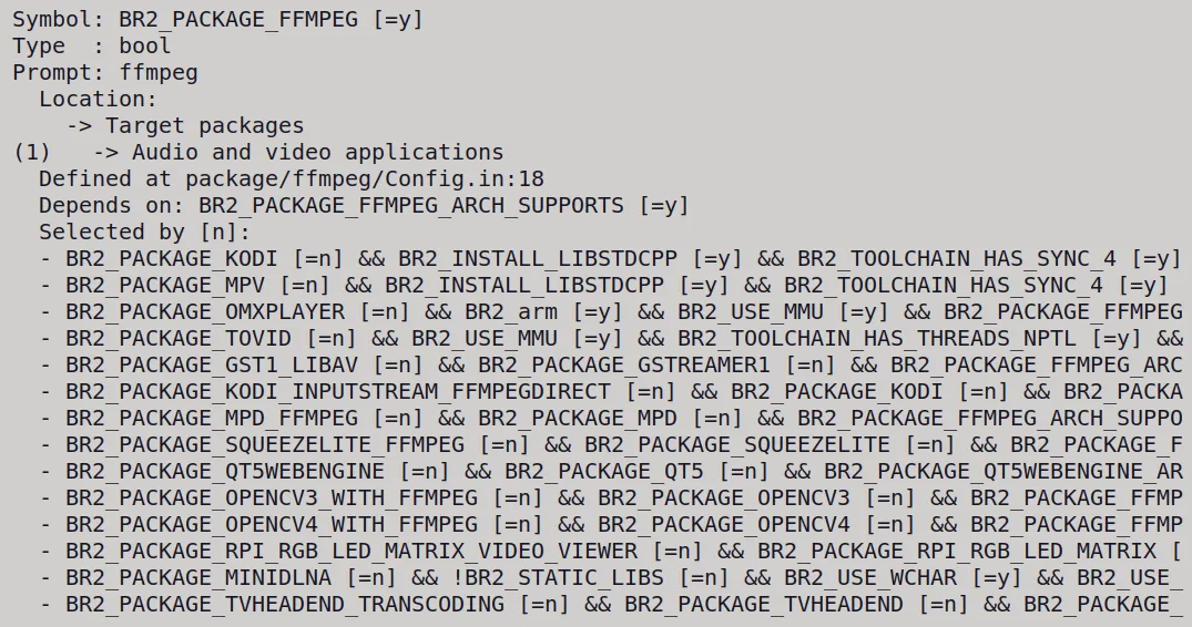

  2. Add V4L2 to the buildroot directory by searching for the keyword "libv4l2".

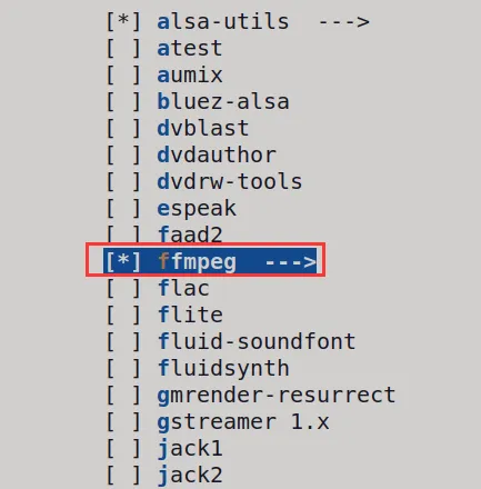

  3. In the buildroot directory, add ffmpeg by searching with the keyword "ffmpeg".

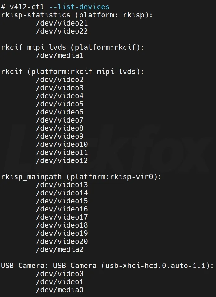

  1. After inserting the USB camera, check if the device is recognized using the following command:
  2. Capture a photo with the USB camera and save it with a specified filename:

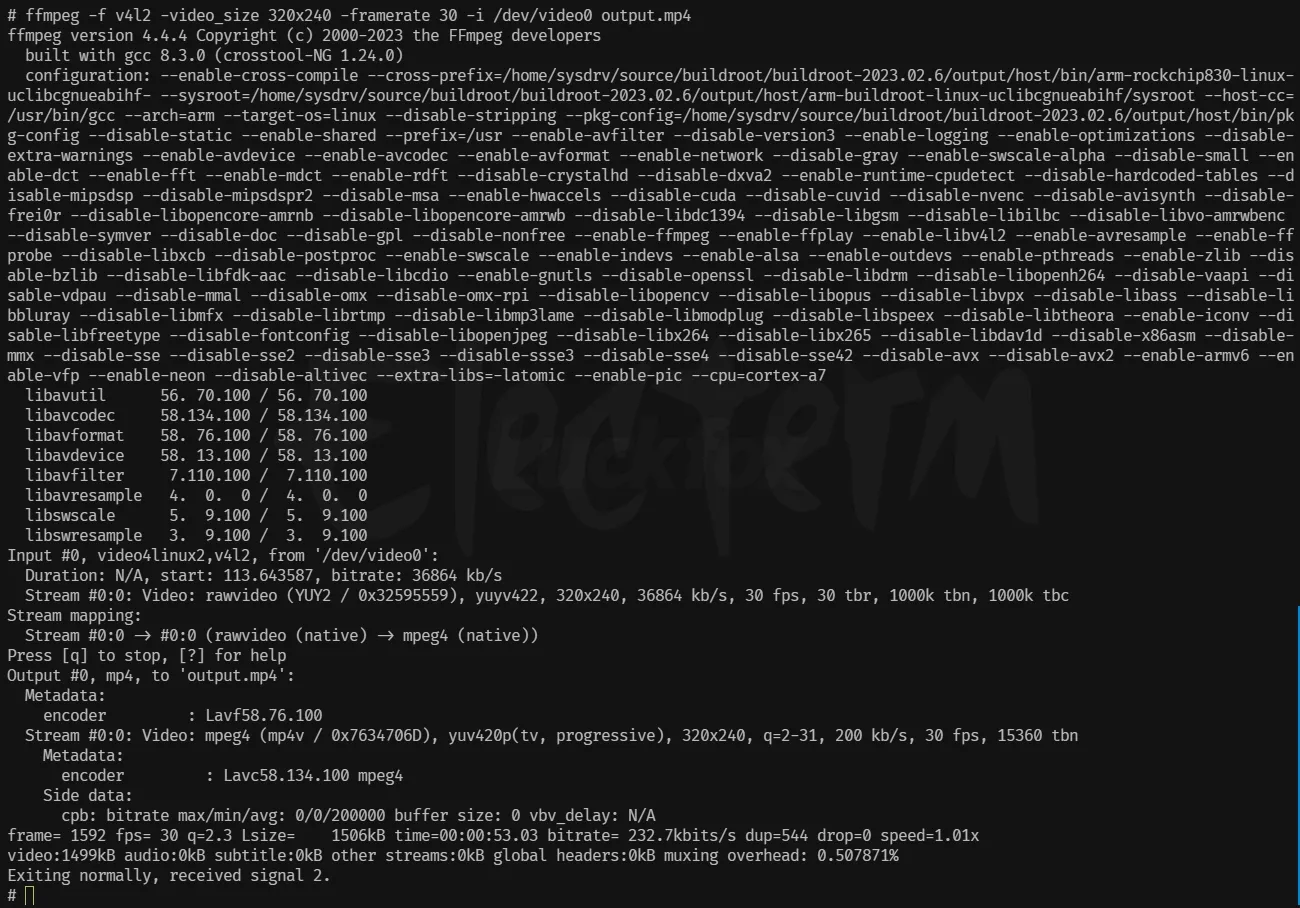

Recording video
  1. The current video recording is based on the Luckfox-Pico-Max development board. Due to the limited memory of Luckfox-Pico series development boards, high-resolution recording is not supported.
    ffmpeg -f v4l2 -video_size 320x240 -framerate 30 -i /dev/video21 output.mp4
  2. If you want to adjust the video resolution, you can use the scale filter to resize the input video frame size to a width of 640 pixels and a height of 480 pixels.
    ffmpeg -f v4l2 -i /dev/video21 -vf "scale=640:480" output1.mp4
  3. Video effect:
