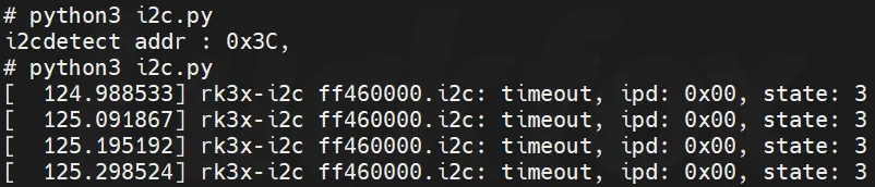

3.4 Run the Program
  1. Use the vi tool to open the file, paste the code, and save it.
    # nano i2c.py
  2. Run the program.
    # python3 i2c.py
  3. Experimental Observations
    The program successfully communicates with the device at address 0x3C in the first run. In the second run, no device is connected (if the device is still not detected after connection, please refer to section 5.1, and configure the pins as pull-up).

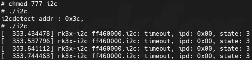

4.8 Running the Program
  1. File Transfer
    First, transfer the i2c program from the virtual machine to Windows, and then transfer it to the development board via TFTP or ADB. Here are the steps to transfer the file from Windows to the development board using ADB:
    adb push path_to_file destination_on_development_board
    eg: (Transferring the `i2c` file from the current directory to the root directory of the development board)
    adb push i2c /
  2. Running the Program
    Modify the permissions of the i2c file and then run the program:
    # chmod 777 i2c
    # ./i2c
    The first run successfully communicated with the device with address 0x3c, but the second time the device was not connected:
