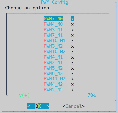

  2. Select Advanced Options:
  3. Select PWM:
  4. Select the PWM interface you want to enable, here we use PWM7_M1 as an example:
  5. Choose enable, and after selecting, press Enter to confirm, then press Esc to exit:
  6. Reboot the development board.

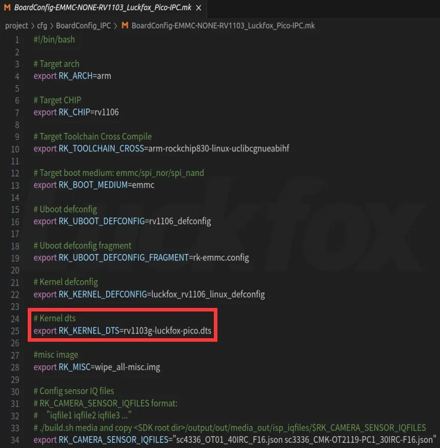

5.1 Modify Device Tree File
  1. Device Tree File Paths
    • Development Board Configuration File
      In the <SDK directory>/project/cfg/BoardConfig_IPC/ directory, there are configuration files for different models of development boards. These files primarily include configuration parameters for various Luckfox Pico board models, covering aspects such as target architecture, boot medium, Uboot and kernel configurations, and partition settings. The SDK directory structure is as follows:

      Among them, RK_KERNEL_DTS specifies the Device Tree Source (DTS) file for the kernel. Taking Luckfox Pico as an example, by opening the BoardConfig-EMMC-NONE-RV1103_Luckfox_Pico-IPC.mk file, we can see that the file pointed to by RK_KERNEL_DTS is rv1103g-luckfox-pico.dts
    • Device Tree File Path
      Based on RK_KERNEL_DTS, the device tree file path for Luckfox Pico can be determined as follows:
      <SDK directory>/sysdrv/source/kernel/arch/arm/boot/dts/rv1103g-luckfox-pico.dts
