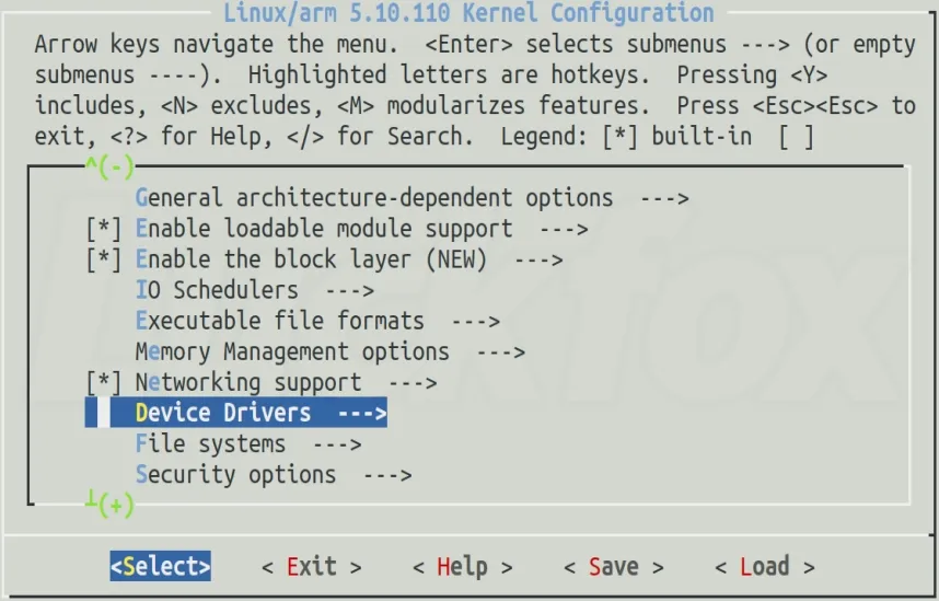

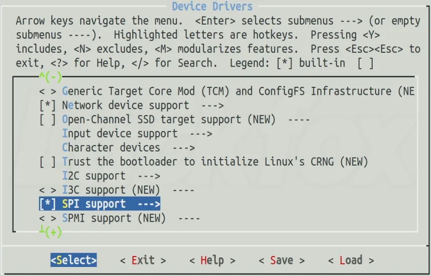

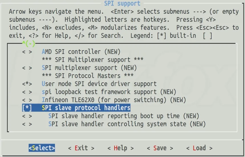

1.2 Modify the configuration
  1. Select "Device Drivers"
  2. Select "SPI support"

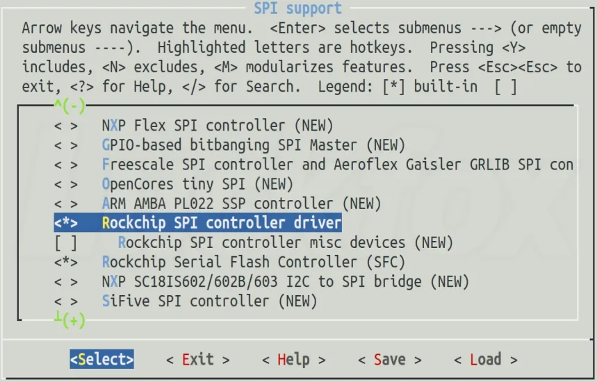

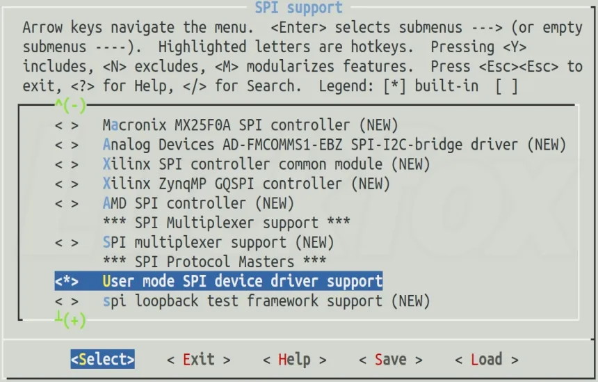

  3. Modify the configuration
    • Configure user space direct SPI interface operation
    • Enable "Rockchip SPI controller driver" for the Master by selecting "Y"
    • Enable "SPI slave protocol handlers" for the Slave by selecting "Y"

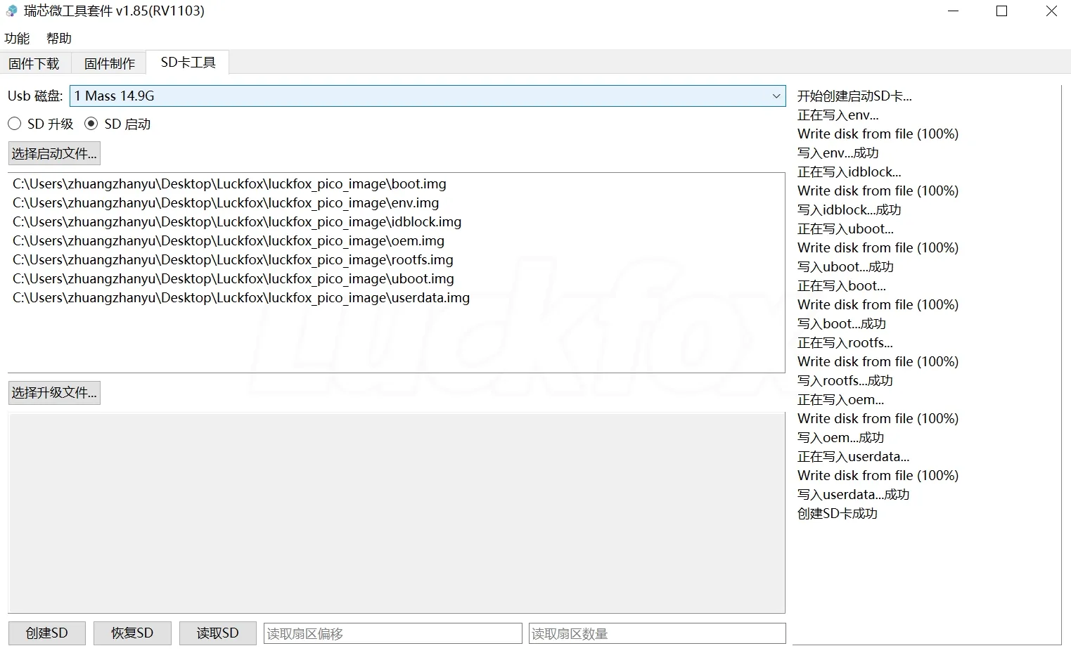

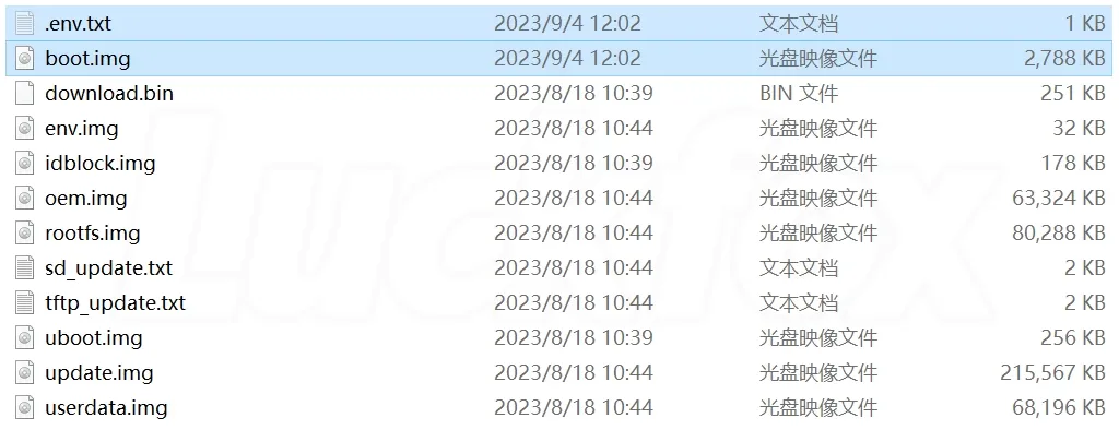

2.3 Flash the Firmware Again
  1. After successfully compiling the kernel, the generated files can be found in the <SDK directory>/output/image directory.
  2. Replace the boot.image and env.txt files in the original firmware.
  3. Recreate the SD card. For Luckfox Pico Plus, you may only need to modify the relevant partition.

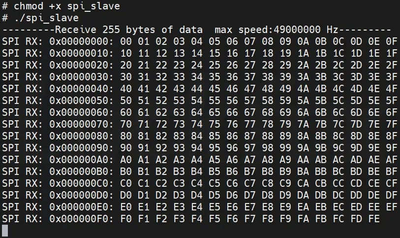

Through the following two programs, SPI communication between the Master and Slave can be achieved.

Slave side
#include <stdio.h>
#include <stdlib.h>
#include <stdint.h>
#include <fcntl.h>
#include <unistd.h>
#include <linux/spi/spidev.h>
#include <sys/ioctl.h>
#include <string.h>
#define SPI_DEVICE_PATH "/dev/spidev0.0"
int main() {
int spi_file,ret;
uint8_t tx_buffer[50];
uint8_t rx_buffer[255];
/* Open the SPI device */
if ((spi_file = open(SPI_DEVICE_PATH, O_RDWR)) < 0) {
perror("Failed to open SPI device");
return -1;
/* Configure SPI mode and bits per word */
uint8_t mode = SPI_MODE_0;
uint8_t bits = 8;
if (ioctl(spi_file, SPI_IOC_WR_MODE, &mode) < 0) {
perror("Failed to set SPI mode");
close(spi_file);
return -1;
if (ioctl(spi_file, SPI_IOC_WR_BITS_PER_WORD, &bits) < 0) {
perror("Failed to set SPI bits per word");
close(spi_file);
return -1;
/* Perform SPI transfer */
struct spi_ioc_transfer transfer = {
.tx_buf = (unsigned long)tx_buffer,
.rx_buf = (unsigned long)rx_buffer,
.len = sizeof(rx_buffer),
.delay_usecs = 0,
.speed_hz = 49000000, // SPI speed in Hz
.bits_per_word = 8,
while(1)
/* Clear buffer */
memset(rx_buffer,0,sizeof(rx_buffer));
/* Waiting for data */
do {
ret = ioctl(spi_file, SPI_IOC_MESSAGE(1), &transfer);
} while (ret < 0);
/* Print rx_buffer*/
printf("---------Receive %d bytes of data max speed:%d Hz---------\n",ret,transfer.speed_hz);
printf("SPI RX: 0x%08X:", 0);
for (int i = 0; i < ret; i++) {
printf(" %02X",rx_buffer[i] );
if ((i + 1) % 16 == 0){
printf("\nSPI RX: 0x%08X:", i+1);
printf("\n");
/* Close the SPI device */
close(spi_file);

3.7 Slave-Side Data Reception
This code segment starts by clearing the data buffer and then checks the return value of the ioctl function to determine if any data has been received. If no data has been received, it enters a loop to wait for data from the master. Upon receiving data, the ioctl function returns the length of the received data. Subsequently, it prints the received data along with relevant information in hexadecimal format, clears the data buffer, and proceeds to the next round of waiting for data.
while(1)
/* Clear rx_buffer */

4.4 Experimental Observations
  1. After running the program on the Slave side, it waits for the Master side to send data.
  2. Running the program on the Master side, it sends data to the Slave side.
  3. The Slave side successfully receives and outputs the data, then enters the next waiting cycle.
